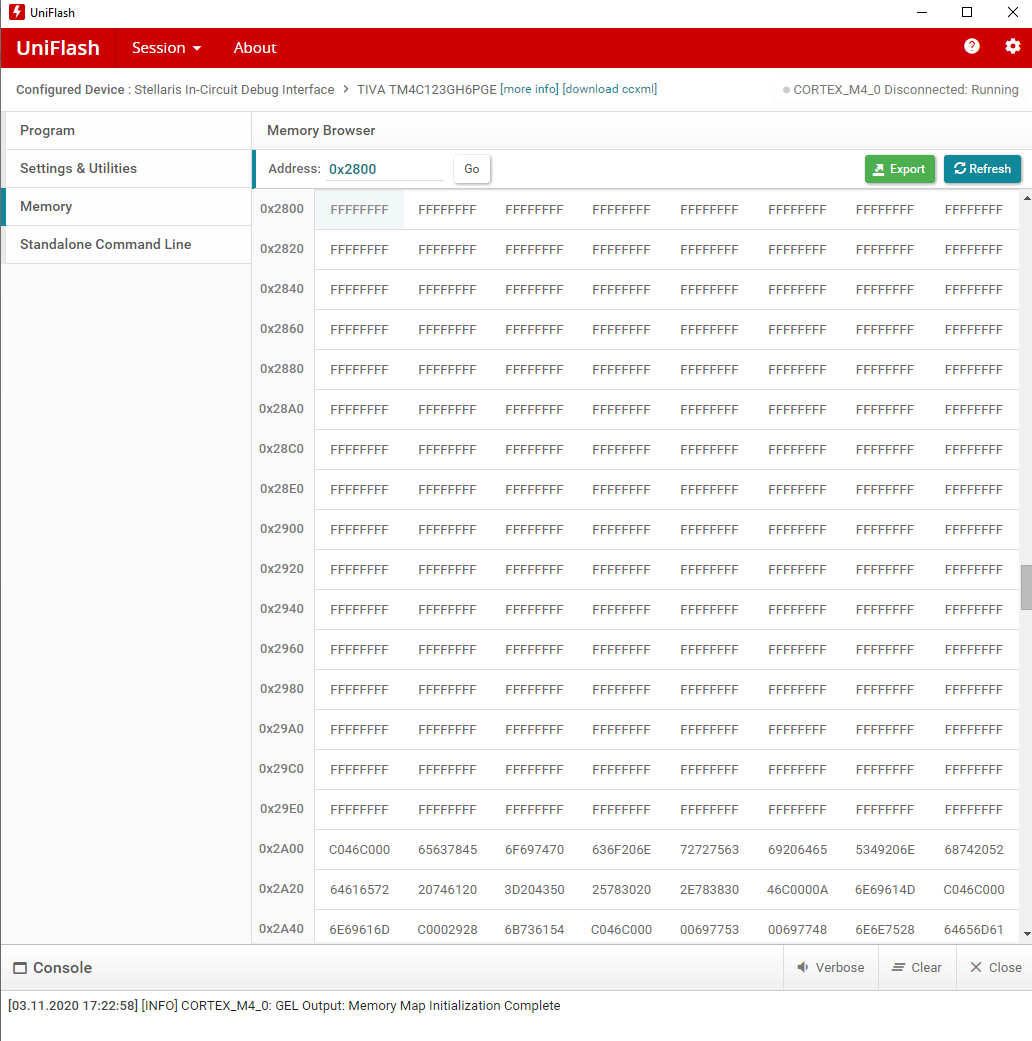

    I tried to program the rest of the code first , then program first page including 1024 bytes that is first page.
    But not success  after power down when loading program.
    So , I did program at starting at APP_START_ADDRESS + 1024, last program APP_START_ADDRESS. Is it right ?

    There is a method CheckForceUpdate in bl_check.c.
    I did program rest of the code, but not first page. First page Filled with 0xFF.
    If i debug this method return 1 as expected, if the first page is filled 0xFF.
    I think this part not working correctly when power down, or bootloader program area is damaged. How can it be ?

    There is uniflash memory browser image after power down device.

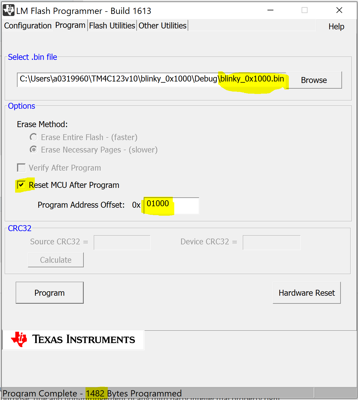

    I am not sure which interface you are using, but I checked this out using a UART serial bootloader and LM Flash Programmer.  I first programmed the application code that was linked to start at address 0x1000. Then I programed the stack pointer and reset vector starting at address 0. It is important that the application not be in the first flash sector as the LM Flash Programmer will cause that sector to be erased before programming the reset vector.

  • Ok, here is a detailed example. First, I have two projects in the attached .zip file. Use the Code Composer "File"->"Import" feature to import these two projects into your workspace. (I used Code Composer Studio version 10.1 and Code Generation Tools version 20.2.3 to generate these projects.
    /cfs-file/__key/communityserver-discussions-components-files/908/blinky_5F00_0x1000.zip
    Start with an EK-TM4C123GXL launchpad with erased flash. Use LM Flash Programmer to program the file blinky_0x1000.bin into the device. Start by configuring LMFlash Programmer to use the serial interface. You will need to determine which COM port is used by your EK-TM4C123GXL board. (You can use Windows Device Manager.)
    Program the first file using an offset of 0x1000. Make sure the "Reset MCU After Program" is selected.
    It should program 1482 bytes.
    Now program the reset vector at location 0 as shown:
    It should program only 8 bytes.
