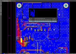

  • Hi
    Sorry for the late response. Today I completed my Circuit Design and PCB design and now gerbers are ready for order but before move forward, it will be a great help if you can verify my Schematic and PCB layout and let me know your thoughts on that
    Waiting for your valuable reply 7870.Top.pdfL4-BTM.pdf1768.Schematic.pdfL-2-VCC.pdfL3-GND.pdf

  • Hello Saikat,
    No worries, glad that you were able to make some progress on your end. I will set up a review with the team to review your schematic and board layout. I should be able to get you any feedback by no later than Wednesday. Thank you for the files and your patience!
    Isaac
  • Hello Saikat,
    The schematics you posted did not have values on the components, so I will not be able to comment on values selected but overall the notes were on the layout and not so much on the schematic. I will post the notes tomorrow, thank you for your patience!
    Isaac

  • Hello Saikat,
    Attached you can find the notes on the schematic and layout:
    Schematic & Layout Review Notes.docx
    It might be helpful to review our app note on best layout practices for a motor driver, it contains more information on some of the notes I provided in the document above: https://www.ti.com/lit/an/slva959a/slva959a.pdf
    Thank you for providing values on your schematic, I did not find any areas of concern as far as the values selected went. I hope the FAQ on the RC snubber will help you determine values for that portion of your circuit. As far as TVS diodes we typically do not help customers select these, but I did find an app note that might be helpful in your search for some diodes: https://www.ti.com/lit/an/slvae37/slvae37.pdf
    I hope this helps!
    Isaac

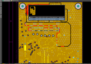

    Q: There are 2 Option available for VM Pin of DRV8350 – We can Connect V-Motor net to VM pin which will have 60V or We can connect 12 Volt regulated Output and as our design and EVM design have the 12v regulator and the 12v regulator only capable to deliver 350mA so why we need increase trace width is not clear to me.
    • Regarding the comments on the PCB layout, if you are using a 12V regulator with 350mA the 20 mil trace should work well, the comment I made also included restructuring some of these connections. The VDRAIN path is somewhat long which can introduce parasitic inductance in itself. Rerouting this as a short and direct trace could help reduce any parasitic inductance.
    • For example: On the EVM we have VDRAIN connecting directly to VM via a polygon pour. I know you have a 0 ohm resistor on yours but something similar would help reduce the trace length.
    Q: Can we pour with ground and use multiple via for stitching and should we add pouring in every layer?
    • This connects to my previous answer but yes you can pour with ground and stitch them through layers of PCB. I am not sure which PCB design tool you are using but some of them have auto stitching features, I usually feel like it does not add enough so you can always go in manually and add more stitching vias. Here is an example of our board:
    • We typically do have pours in every layer, whether it is a ground, VM, or other signal pours can vary. Here is an example of the different ground pours between some layers on the DRV8350 EVM.
