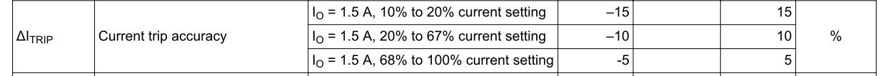

  • Hi Morita san,
    Thank you for your reply.
    Does these characteristics indicate followings?
    xVREF = 3.3 V, 100% current setting → 3.3 V, 71%~100% current setting
    xVREF = 3.3 V, 71% current setting → 3.3 V, 38%~71% current setting
    xVREF = 3.3 V, 38% current setting → 3.3 V, 20% or 33%?~38% current setting
    As the background of this question, we would like to know whether these characteristics indicate an approximate value at each current settings or range of current setting.
    In other words, on the DRV8426’s datasheet, it shows current trip accuracy with range of current setting like as follow;
    Also, is it OK with the following understanding?
    For example,
    xVREF=3.3V 71% Current setting and xVREF=2.343V 100% Current setting are the same VTRIP. (3.3V x 71% = 2.343V)
    Both VTRIP is 469mV (TYP).
    Ishiwata
  • Hi Ishiwata san,
    Accuracy(error) goes by mV. VTRIP has +/-25-26mV in all % range. We can consider as follows
    xVREF = 3.3 V, 100% current setting → 3.3 V, 71%~100% current setting -> +/-26mV
    xVREF = 3.3 V, 71% current setting → 3.3 V, 38%~71% current setting ->+/-26mV
    xVREF = 3.3 V, 38% current setting → 3.3 V, 20% or 33%?~38% current setting -> +/-26mV
    regards
    Shinya Morita
