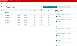

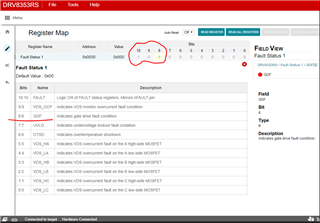

I am attaching the error Register screen shot. GDF bit is set as 1.

    After the fault occurs, can you hit the "Read all registers" button, because if there is a GDF reported in the Fault Status 1 register, then there should be a fault bit set in the VGS Status 2 register to indicate which MOSFET caused the VGS fault?
    Also, what gate drive strength are you using when switching the MOSFETs? It could be that your IDRIVE setting is too high. I would recommend using the lowest IDRIVE setting allowed for the device as the MOSFETs on the EVM are low Qgd, and it doesn't take much gate current to switch the MOSFETs quickly.

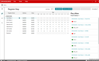

  • Hi Alicia,
    Please find below  2 images - details of all the 8 registers before and  after the fault occurs. Pls suggest what  to do next.

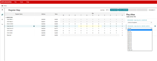

    Because you are using the SPI version of the device with the GUI, you can change IDRIVE with the GUI by writing to the Gate Drive HS and Gate Drive LS registers. Refer to section 8.6.2.2 Gate Drive HS Register and section 8.6.2.3 Gate Drive LS Register to see which bit values correspond to which IDRIVE settings.

    In GUI, could not find any option to change IDRIVE setting.  Could you please crosscheck this ? As per one  of the post ,
    The IDRIVE setting can be changed in the follow registers (Gate drive HS & Gate Drive LS) by doing the following:
    1. Select Gate drive HS to open Field View
    2. Open drop-down menu for IDRIVEP_HS/IDRIVEN_HS and select the lowest setting, as shown below
    3. Once the lowest setting have been chosen for both IDRIVEP_HS and IDRIVEN_HS press the "WRITE REGISTER" button which should be enabled (located to the right of the "READ ALL REGISTERS" button
    4. Repeat with Gate Drive LS for IDRIVEP_LS and IDRIVEN_LS
