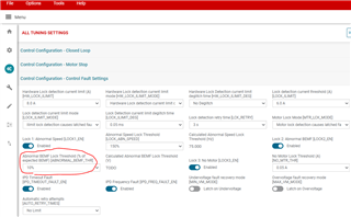

    Now I sometimes get stuck with the messe: "CLOSED_LOOP_ALIGNED" but motor is not turning any more also no error is present?!
    Only a complete reboot will solve this...any idear?
    BRclosed_loop_aligned

  • Hi Andreas,
    Glad that the "Find Address" button resolved the connection issue. We will update the GUI to inform user about possible I2C target address mismatch in case of communication error.
    Regarding the device stuck in CLOSED_LOOP_ALIGNED, could you please check what the [ABNORMAL_BEMF_THR] is set to?
    If it is set to 10%, could you please try increasing it to see if the ABNORMAL_BEMF fault will get triggered when the device is in CLOSED_LOOP_ALIGNED without the motor spinning?
    Eric C.
