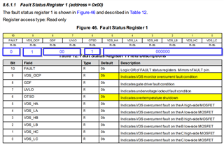

    To address how to debug using SPI fault register is simple if you were to read out and print the bits from the register in binary. Look at the following table of fault register 1. If I read Fault Register 1 (0x00) and what came back was 0100100000 in binary (0x120 in hex). Looking at the table I can see bit 9 and 6 are set to 1, meaning in this scenario I get the following faults "Indicates VDS monitor overcurrent fault condition" and "Indicates overtemperature shutdown"
    remember there are TWO fault registers, reading from both will be able to tell you a lot about what is going on.

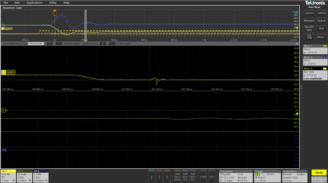

    But on the driver strength that is an appreciated point and good faq/app note. By PWM I meant the SH signal. That generally looks fine. Looking at SL and GL do look a bit troublesome. There is significant undershoot on GL/SL when the high side fet turns on, until I bring the high side gate drive strength down to 80 mA. I'd rather have a little bit less switching losses though. Are there any solutions to this undershoot problem? Do you think negative voltages on GL would cause this failure of the driver IC?
    Yellow is GL at 1 A high side gate strength.
    Now at 80 mA.

  • Hi Lee,
    So the waveforms you've provided lead me to believe that maxing out IDRIVE is in fact causing issues in your system. The undershoot you are seeing is significant and will potentially damage the device as this is pushing GLx outside of the recommended ratings. There are ways to help minimize the noise you are seeing on GLx but the chances of completely eliminating that noise might not be possible without lowering IDRIVE.
    I'd say look into RC snubbers: https://e2e.ti.com/support/motor-drivers-group/motor-drivers/f/motor-drivers-forum/991693/faq-proper-rc-snubber-design-for-motor-drivers
