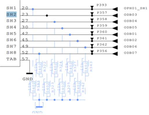

  • Hi Murugavel
    When customer not populate MOSFET at HB7 and HB8, does it require connect SH7 and SH8 to ground? Customer is connecting the SH7 and SH8 to ground through 10k resistor, is it okay?
    Thank you
    Scarlett
  • Hi Scarlett,
    SH7 and SH8 must be directly to GND or use 0 ohms. With 10k because of the leakage current there will be ~ 1V on the node.
    Regards, Murugavel
  • Hi Murugavel,
    In the application, when the channel is not in use, the SHx is wired to the port PIN even if devices such as MOS are not attached, and if directly grounded or 0Ω grounded, there may be wire burning or resistance damage when the SHx SCB occurs. As you could see below, 0402 resistance is 1/16W, after high temperature derating is 30mW, 16*16/R needs to be less than 30mW, so R>8.5k.  The customer think the VDSOV false positive of the channel that is not used can be shielded by the software. Is it true? Please confirm the resistance value selection when the channel is not used.
    Thanks for your help.
    Mingkang
  • Hi Mingkang,
    My assumption is the port pins are configured as inputs not outputs. Is this correct? So if they are inputs there should not be any voltage output from the port.  Anyways if the customer wants to use a resistor they should be aware, because of leakage current possible up to 150 uA from the SHx will result with some voltage = I(leakage) * R on the pin. So assuming 10k will be used the voltage on it could be up to 1.5 V.
    "The customer think the VDSOV false positive of the channel that is not used can be shielded by the software. Is it true?". Yes they can do this.
    Regards, Murugavel
  • Hi Murugavel,
    The port PIN needs to consider the possible short to Vbat condition, which is independent of the configuration as input or output
  • Hi Mingkang,

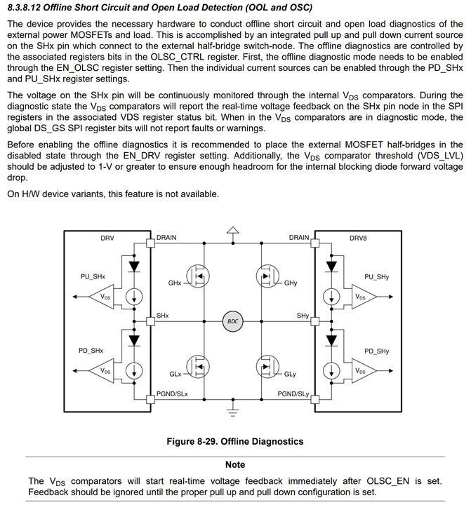

    Thanks for the clarification. I hope the info in my previous message helps in determining the resistor value. That said, I also want to point out if the customer is using these resistors to detect a open load we already have that feature integrated in the device and we recommend using it instead of an external circuit. May I know the purpose of these resistor divider based inputs to GPIO? Are they digital status or analog input of the MCU? Why it is done for unused output only?
    If these resistors are for all channels can get a schematic and purpose of these GPIO connections?
