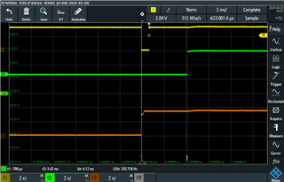

This is the scope of output current and nFault pin -
yellow is nFault
blue is current of the motor
I can see it happens before the motor is consuming current. I wish to understand why that might happen and how to solve it.

  • Hey Michael,
    Looks like the low pulse is for 1ms, which is interesting since the tRETRY time is 3ms, I would expect at least 3ms long pulse. Can you take a scope capture monitoring VM and VCP as well?  This would let use rule out UVLO and CPUV as the cause.  either of those could reset in quicker than 3ms.
    The things that can cause nFAULT to go low are listed in 7.3.13 Protection Circuits.  Given that this happens at startup of the motor, I would usually suspect momentary OCP or a Pre-Driver Fault (PDF).

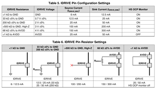

    Looks like the board has IDRIVE disconnected, which is a setting of 100-mA source and 200-mA sink.  Can you run the calculation for IDRIVE current in 8.2.1.2.2 IDRIVE Configuration and make sure that's the right option for the FETs on the board?

    My Qgd is 2.9 nC
    so my current should be - 9.6mA (300nS) to 29mA(100nS) according to section 8.2.1.2.2.
    I putted a 33k,200K,0 Ohm pulldown resistor at IDRIVE (R236 in my schematics). that didn't fix my issue.
    1. what resistor should be according to my FET's ?
    2. I would like a further explanation regarding why can't I just put the maximum value as in my initial state.

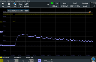

    VCP, VM -
     yellow is nFault.
    green is VCP in top, VM in bottom picture

  • Hey Michael,
    Scope captures look good, VCP and VM look perfectly stable.
    Agreed on your calculation, though the rise time is also unique to each fet so 100ns / 300ns might not be the best for your FET.  Given your math I would pick the 12.5 / 25 mA (33 kΩ) IDRIVE setting.

  • Hi
    thanks for replying
    attaching Scope photo of nSleep, nFault, PWN pin
    Yellow - nFault, Green - PWM(EN), Brown - nSleep.
    as you can see, the moment we rise the nSleep, even before generating PWM, we get an instant interrupt in nFault.
    are there any other pins that may cause this interrupt ?
    Michael.
  • Michael,
    Yes, according to that other E2E thread this is expected behavior, it is part of the design of the device.  When nFAULT goes high after the pulse it indicates the device is awake and ready to function normally.  I recommend just ignoring the nFault signal in your code for x us after turning nSLEEP from low to high.
