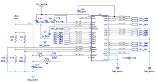

I am working with a DRV8350HRTVT but facing some problems with proper motor rotation. I am using the following conditions:
- 1x PWM Mode (MODE Pin, 560k Ohm Resistor, Hi-Z)
- INHC (Dir, LOW)
- INLC (Brake, HIGH)
- Hall Sensor signals are directly connected to INLA, INHB, and INLB without an MCU (proper pull-up resistor and filtering are implemented)
- PWM signal generated by MCU (STM32, 20 kHz, 10% duty cycle only for testing)
- VM/VDRAIN -> Power Supply 16.8V ~ 18V (3A)
- IDRIVE -> tied to 3.3V
- VDS -> Hi-Z

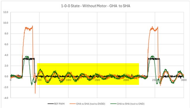

Since the motor was only vibrating I tried to check what was going on with the signals first (hall sensor, phases, GHX, GLX, SHX). I noticed too much noise in some phases and some gates, so before trying to make it work I decided to remove the motor and only check the expected behavior of the driver.

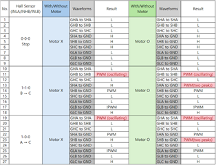

Since I removed the motor I could control the hall sensor signals and check the expected behavior. I obtained the following results:

It seems like the gate for the high-side is not working properly (not for all cases though).

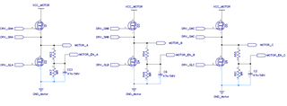

I checked the circuit and driver configuration many times, but I can't pinpoint where the problem might be.
I attached part of the schematic as a reference.
