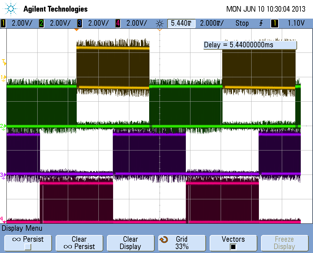

I'm creating four PWM signals which loks like this:
Im trying to move in full step, and I have 100% of PWM duty cycle when i want to grow my current to some value...When I reach that value i'm chopping that current with 50% duty cycle... I'm using Piccolo 28027 to create pwm, and till now i was using PWM chopper module and i get rotation and very big torque... Now when i put this signal from picture my DRV8412 is dead, but i dont know why... When I connected my pwm signals to input at first it was ok and my motor was rotating fine... I tried few times and it was OK in both directions... Then suddenly my drv8412 was dead.... Then i changed PCB where i had another DRV and that drv drop dead too... When i dont have PWM inputs connected my power consumtion from drv8412 is aprox 85mA and when it was working it was aprox 50mA...
Can you please help me and tell me where I'm wrong and what i have to change to get my driver to work fine????

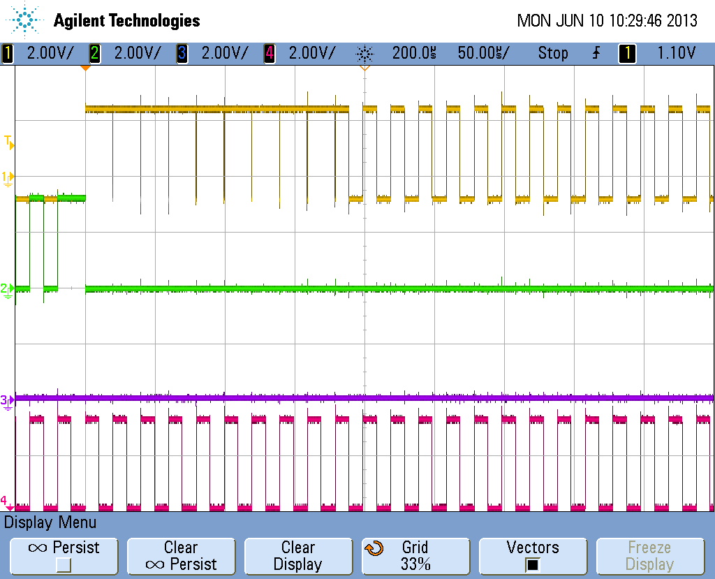

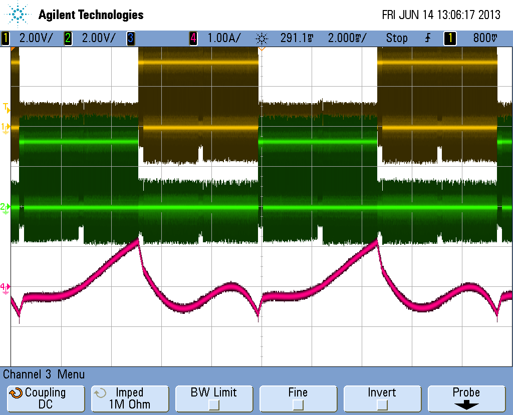

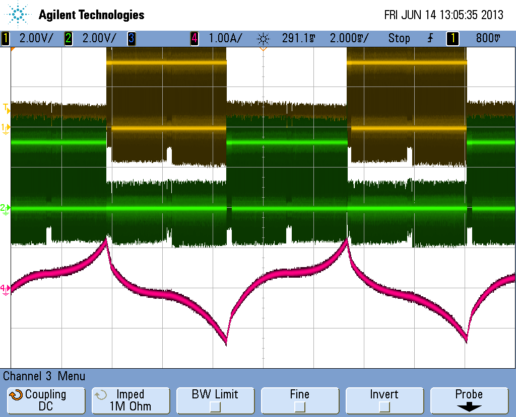

  • I have few theoretical questions about signals that i get on my scope...
    Yellow: input PWMA
    Green: input PWMB
    Red: Current probe on Output A
    I'd like to get theoretical values of current in full step but i have some problems in getting that values...
    Theoreticaly i calculated time of current grow for my motor it is 0,5A in 200us... I implemented that at start of every phase period, and i get current change in 0,5A... But then I'd like to chop current with 50kHz PWM signal with 50% duty cycle and have constant current value... When I chop with 50% duty cycle i get current grow like on picture 1... When i change duty cycle to 40% i get some time my current in that value but then my current also goes up (picture 2)...
    I know that if id like to have constant current i have to had close loop current control, and i'm working on that, but i'd like to know why current grow in my case???
    My motor phase resistance is: 1,6ohm
    Inductance: 6,8mH

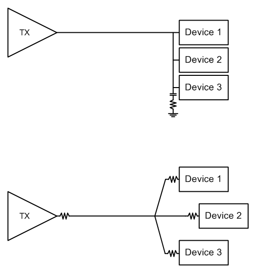

  • Ross, sorry if you understand me wrong..
    I'm asking if i can connect 3 different drivers DRV8412 paralel on same port of MCU... I'd like to have 4 PWM for controlling 3 different DRV8412 like on picture below...
  • It should be generally ok to connect 1 MCU output to 3 PWM_A pins on 3 DRV8412 devices, but you may want to add minor filtering to minimize reflections from stubs.  Input leakage is spec'd as a max of 100uA, so the driver needs to source >300uA.  Here are 2 ways to terminate:
