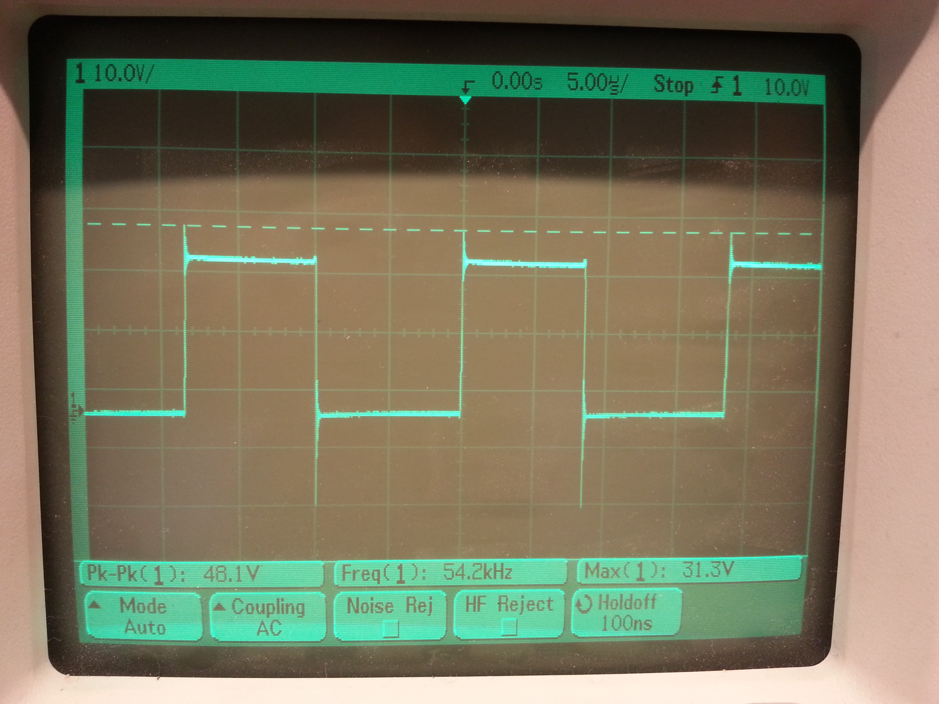

Hello!
I have now replaced the DRV8301 chip. Everything is working fine, but something strange happend. The first 5 minutes after connecting to my 30V powersupply, the 5V was very unstable again. Than, suddenly, it went "normal". And now, it have been perfect for many hours. Maybe this is because of some bad connections, I don't know.
I have tested a lot with different voltages, and everything seems normal. I have run with up to 58V voltage from power-supplies.
Here is an o-plot from channel A:
I have not connected my batteries yet. I want to be shure that connecting doesn't brake the DRV-chip again.
Could you guys help me with this? Is there some other parametres or hardware-solution that I can adjust to prevent damage?
Good to hear Fridell,
Yes, for most MOSFET's series resistance will need to be added to prevent ringing on the outputs. I would check the outputs up to your specific battery voltage using a power supply first.
Good to hear and no problem.
Bulk capacitance on PVDD can also help to limit the voltage ramp rate and prevent any unwanted overshoot.
