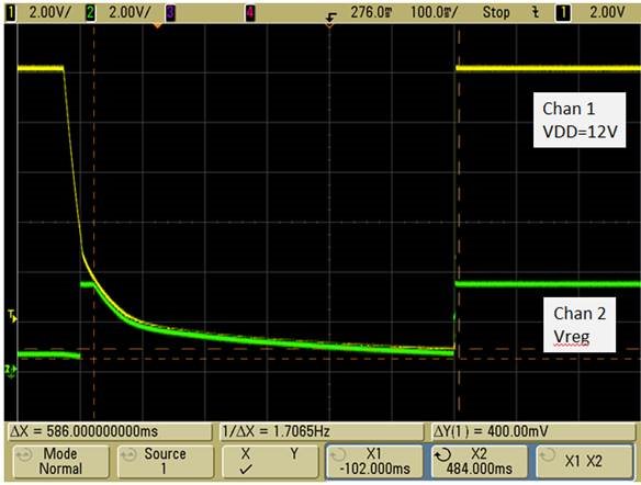

We have a board where the DRV8412 can't be control by the PWM input. After some investigation, we found that the VReg of the DRV8412 is not 3.3V. Repeatedly power cycle, VReg always can't start, it measured 0.6V. At this point, we also observed voltage different between AGND and GND is 0.2V.
Also, we realised that if we do power recycle very fast, like within 0.5s, then VReg will start normally, and the PWM can drive the motor.
Observed that at the beginning the Vreg is at 0.6V, once power down condition happens, it raised to 3.3V and then dropped according to the VDD.

    Can you also provide a scope capture of the failure? Please capture the rising edge of power, and VREG.
