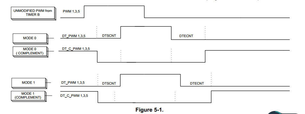

         Dead Time Control (DTCTL)
         Dead Time Count   (DTCNT)

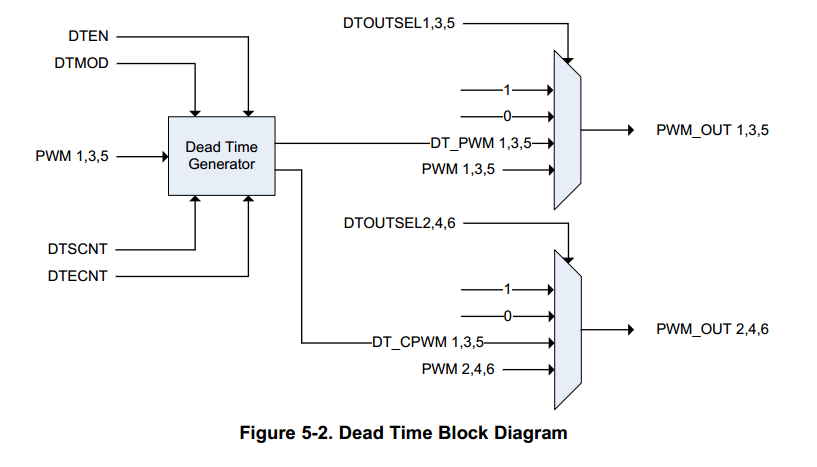

         Dead Time Output  (DTOUT)
          I configured as follows in the program:
          DTCTL = 0x0001;
          DTCNT = 0x7F7F;
          During debugging, it is found that the PWM complementary waveform has only one edge (the rising edge / falling edge) of the 5uS, but DTCNT, I have all configured the same clock count.

    2. How is your DTOUT configured?

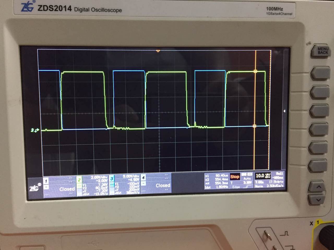

    3. Do you have a waveform that you can show - please take the measurements at the pin?
    James.
  • Weiwei,
    1. I can see your scope shot now. CH2 (green) is the low side gate and CH3 (blue) is the high side gate.
    2. It looks like your frequency is 20kHz with 40% duty cycle.
    3. The issue is at the LS turn-on/HS turn-off transition. We will have to understand how your gate driver is designed - there is potentially some imbalance in your turn-on/turn-off transition.

    1.My design intent is: PWM1 3 5 PWM2 4 6 to produce complementary output waveform output pin (with a double edge, but the dead) configuration register can only get single edge dead, the other side will lead to the upper and lower tube to wear MOS.
