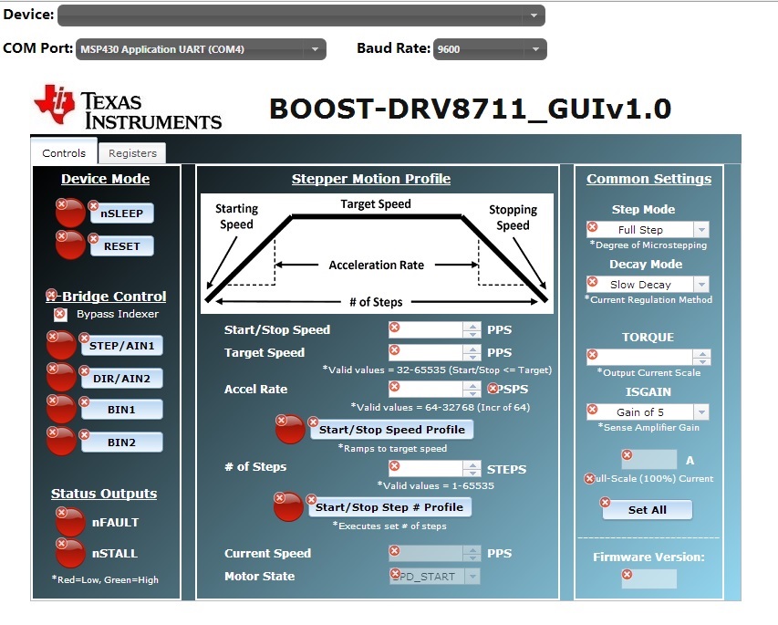

It seems I can download the project to the MSP430G2553, but finally it can not work together with the provided GUI.
It seems the COM port and the speed is properly identified/set up, but the GUI can not find the device, and the red Xs are remaining.
I guess there is no connection with the micro?
Because of all of the above symptoms, I can not even make sure that the hardware work at all....
Please help how to resolve the issue.

  • Hi Zsolt,
    The MSP430G2553 is not being recognized. Is the launchpad COM4? Please check the com ports and confirm there are no other similar USB devices.
    Have you re-tried per the user guide:
    After a successful launch of the BOOST-DRV8711_GUIvX.X.exe, Figure 11 pops up. It may take a small period of time before the GUI connects and the GUI Widgets populate (red X's appear on the widgets while the GUI is connecting). If the GUI does not load after a few minutes (the X’s disappear), a connection issue may have occurred and TI recommends restarting the application.

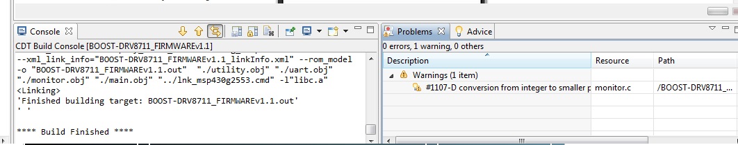

    One more thing. I have realized a warning in the CCS IDE.
    Please see below. I'm not sure if it is a problem, or not, or connected to the GUI issue.
    Thank you.
    Zsolt

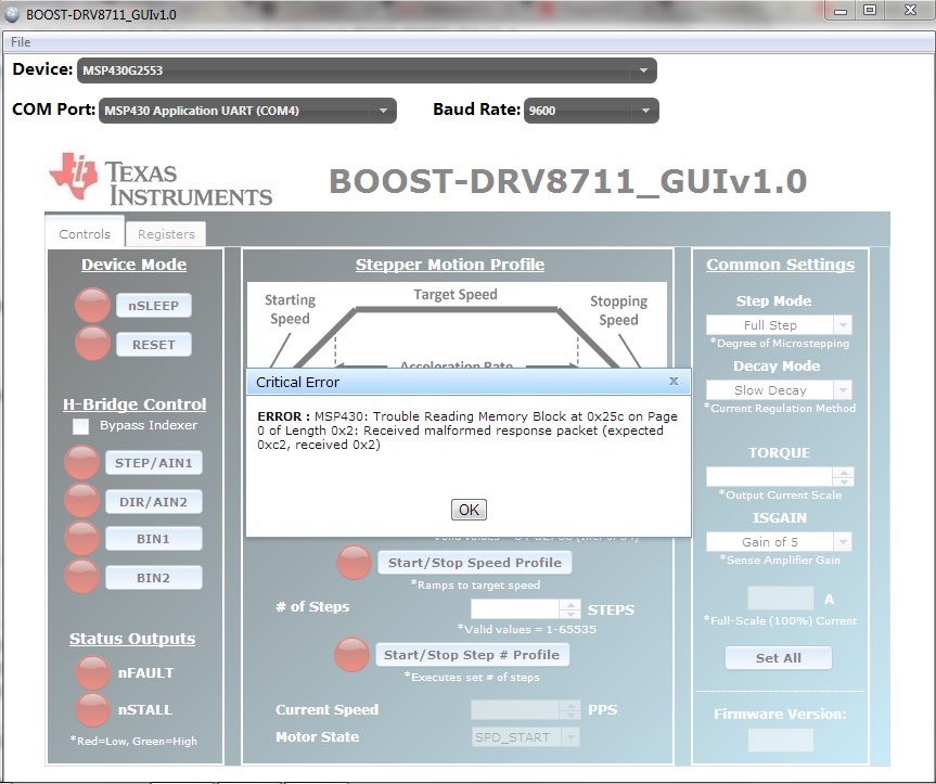

    I downloaded and installed now the latest version of GUI Composer.
    Now, the situation slightly better. GUI identify the controller.
    However I got some error message. Please see below:
    Thank you.
    Zsolt

    Based on the screenshot i previously sent you it seems the mcu try to send some characters to the GUI, but it expect something different. "expected 0xc2, received 0x2" Right?

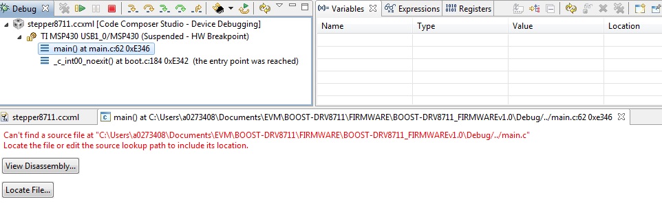

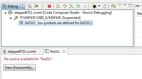

  • Hi Rick,
    If I try method 1, i got two errors.
    The first, when I try to connect to the target (Fig. 8 in the instruction)
    Please see below:
    The second error I got, when I try to load the program, according to Fig. 9.
    Please see below:
    So this way, practically no compilation.
