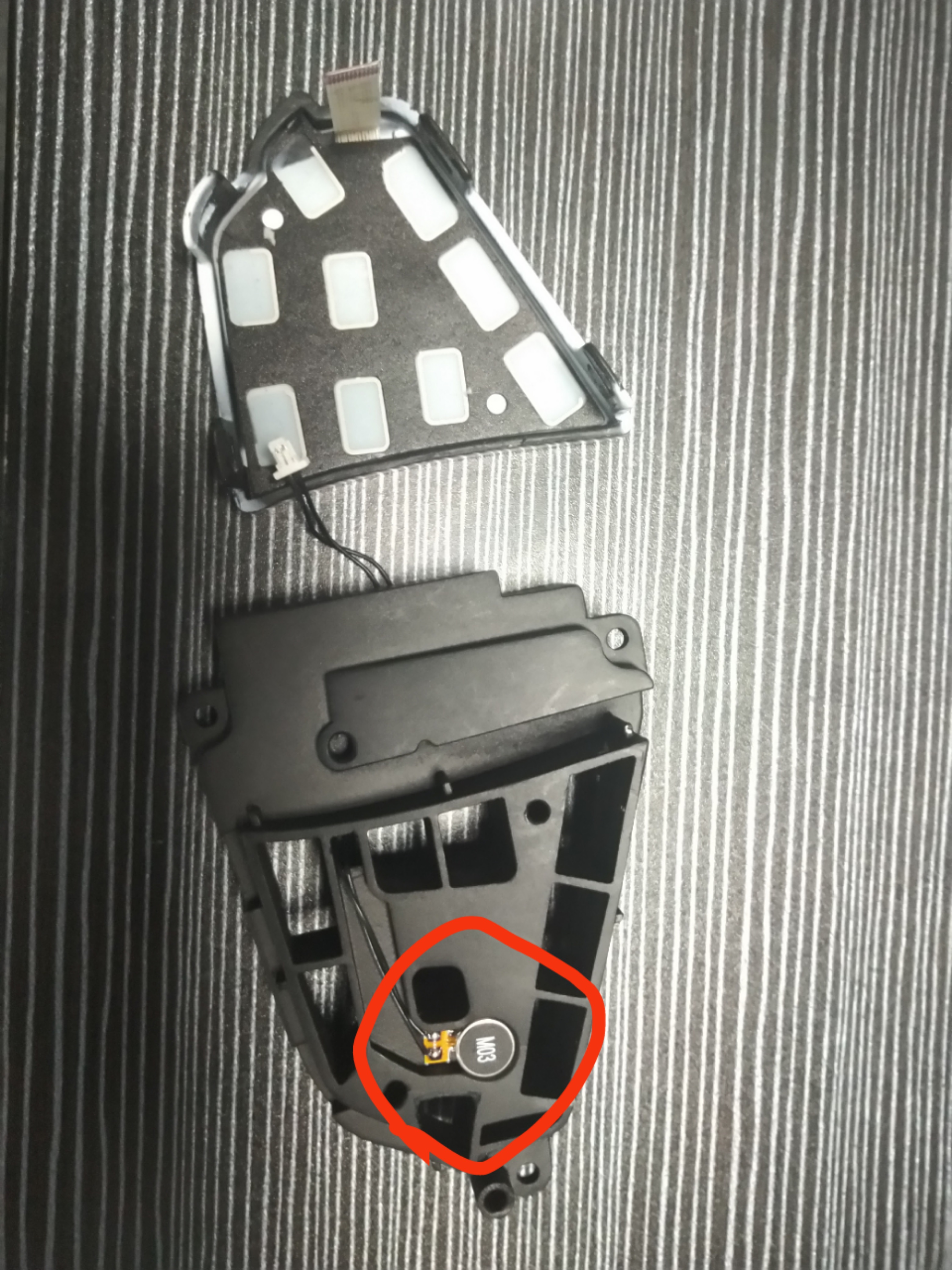

my custom use drv2605 as The steering wheel touch switch,  the motor is LRA ,Spec. as follow:
LRA规格.pdf
but when i use  auto-calibration ,  after initialization vibration cannot close on its own.
the return valve is:
May i know which register can closed its own function. thanks.

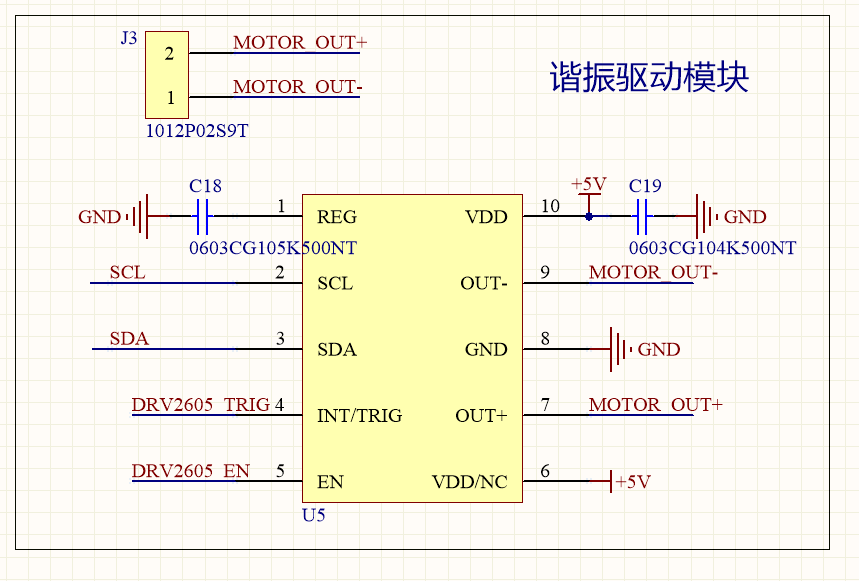

    Could you provide the circuit schematic? Also, is the LRA load attached or glued to a mass? It is important to glue the LRA to a mass (usually we use a 100g metal block). Otherwise, there could be issues with the auto-calibration.
    In addition, the LRA pdf doesn't contain details about the resonance frequency. Do you have these details too?

     Sch.
    Installation method:Above is the panel, the lower is the case. The motor is embedded in the casing and then the panel covered.
