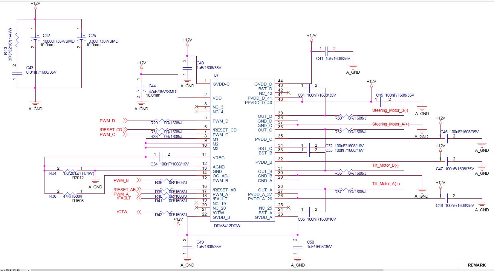

DRV8412: Request a design review.
Part Number: DRV8412
Hello
I Request a design review for DRV8412
Specification is driven by two 3A DC motors.
Best Regards.
  • Hi Louis,
    The schematic looks ok. If you do not need R30, R32, R35, and R37, it is recommended to remove them.
    Zero ohm resistors are not always 0. Some 0R resistors can be 20mOhm or more. This would be wasted power.
