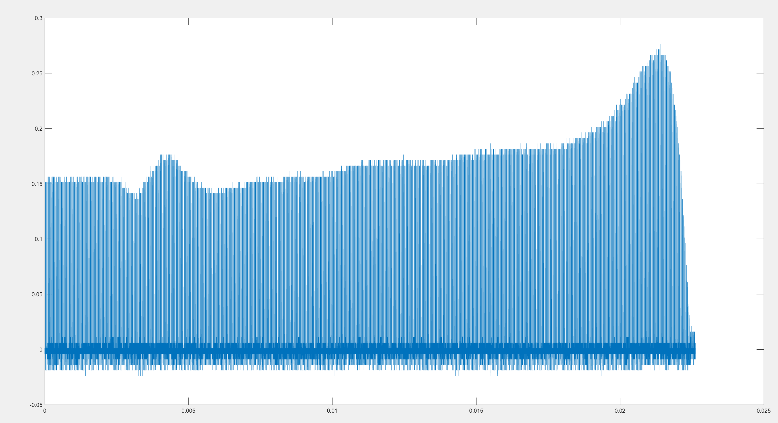

  • VREF is 0.75 V, DECAY is high (mixed), and sense resistor is 0.15 ohm.
    The current is above 1.5 amps, but the time seems to be slightly under 2.5us (typically about 2.3us).
    The exact area where the fault occurs is difficult to pinpoint, so I've included a plot of the general region.

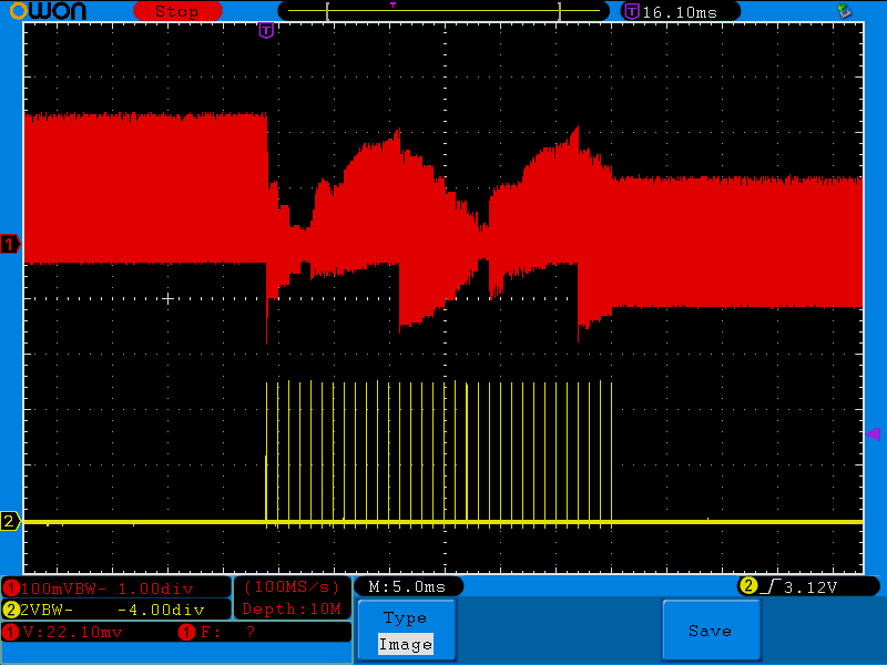

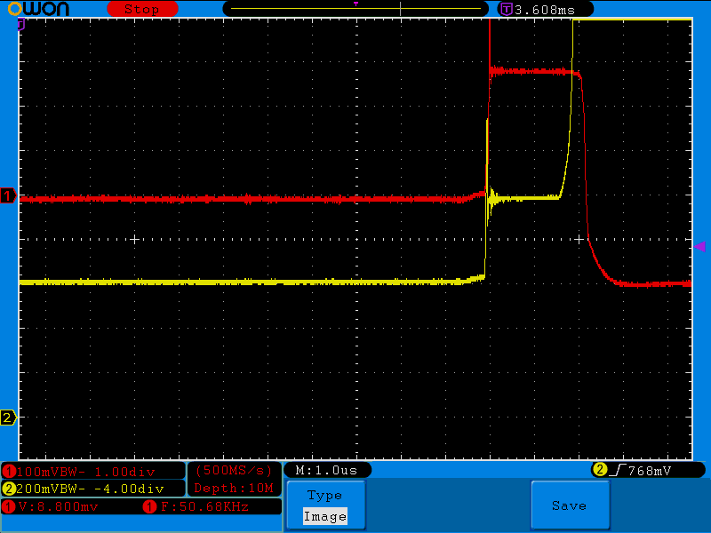

  • Unfortunately, the DRV8821 does not have dedicated fault pins unless I missed something in the datasheet. Such pins would also be useful in determining the type of fault. I also do not have a scope that can trigger on voltage over threshold for a fixed amount of time. I can only capture a rising edge, but ISEN rings above the threshold during normal operation.
    I attached a screenshot of where I believe the fault occurs, since I cannot see the bridges switching afterwards. Red line is ISEN, yellow line is a AOUT1.
    A zoomed out plot of ISEN is very noisy. Red line is ISEN, yellow line is STEP.
    I don't think this is an overtemperature event because the motor stays energized for hours without unlocking, but will unlock right away when forcefully turned right after power on. After an hour, the surface of the chip is about 60 C. I'm not sure about the connection to the thermal pad without having the board x-rayed.

    The following is my assessment based on the images and speculation about the xISEN voltages:
    The last image that you provided shows what looks like one half sine wave and some portion of a second one.
    Of interest is the current prior to the step pulses and current after the step pulses. The current prior to the step pulses appears to be higher than 1A (voltage appears to be >200mV. The current after the step pulse appears to be less than 1A (voltage appears to be ~120mV).
    The difference is prior to the step pulses may be slow decay and after the step pulses is probably mixed decay.
    Slow decay and high voltage can lead to loss of current regulation. Lowering the voltage or adding resistance can help mitigate this.
    Our newer stepper drivers like the DRV8880, DRV8885, and DRV8886 can limit this loss of current regulation. These devices have more decay modes including mixed decay when the current is increasing.
    You would need two of the devices to control two steppers.
