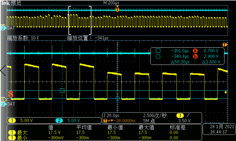

#2:  High-side gate drive voltage,it vary too,check the waveform
    We expect that the high-side voltage waveform can vary if several phases are switching at the same time. This results in some ripple on VCP - Can you measure to see if we can observe any ripple on VCP? You can plot VCP, GHA, GHB, and GHC. The ripple should not be an issue as long as it is <1V. Also check to be sure that VM is not varying since VCP is referenced to VM.

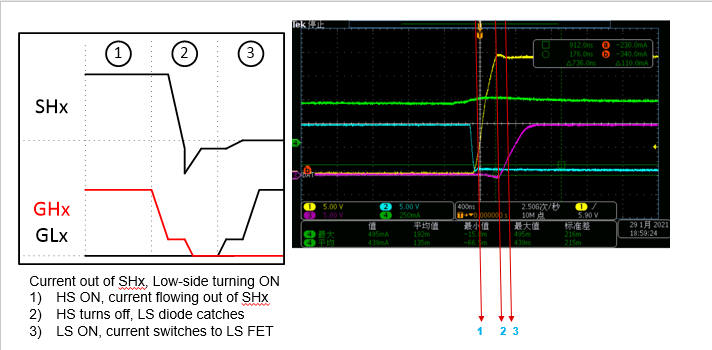

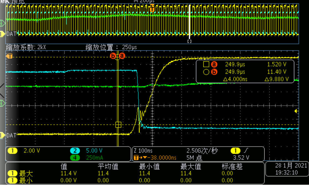

    I have fixed the #1~#3 questions, but still have #4 question:
    as you see the following waveform,
    -- YEL : High-Side MOS VDS    BLU:High-Side MOS VGS    GRN: Current to the Phase Coil   Pink: Low-Side MOS VGS
    I can't get the point that when High-Side MOS VGS voltage reaches  to  0V , the High-Side MOS VDS Voltage still keep high ,
    why the High-Side MOS delay long time (about  delay 350ns) to close,so why,  is the phenomenon is normal ?
    also  you can see  at this time , the current is positive??
    Gate Drive HS Register  set as follows:
    IDRIVEP_HS=120mA      IDRIVEN_HS =1640mA
    Gate Drive LS Register  set as follows:
     I also have tried the  IDRIVEP_HS=820mA ,still have the question. so pls
    but check the following waveform ,when the current is negative , the delay time is short,   plz help
    thankyou~
  • Hello again!
    I have a few pictures and animations that may be helpful: GateDriverSwitchingBehavior_020221.pptx
    Since you are measuring at the high-side MOSFET VDS (VDRAIN-SHx) rather than the low-side MOSFET VDS (SHx-GND) your plots are the opposite of mine.
    Your first shot is similar to my page 3: the high-side gate turn OFF is controlling the switching event (turning OFF of the high-side MOSFET, the low side body diode catches and HS VDS exceeds VDRAIN). In this case the low-side MOSFET goes from VDS = VDRAIN to VDS = -0.7V when the HS gate turns OFF & the low-side body diode catches through reverse recovery (Qrr = 145nC, trr = 82ns from the CSD18540Q5B datasheet). Next the low-side MOSFET turns ON and the low-side MOSFET VDS goes from -0.7V to ~0V very quickly.
    Your second shot is similar to my page 5: the low-side gate turn ON is controlling the switching event (turning OFF of the high-side MOSFET, the high side body diode catches and HS VDS goes negative). In this case the low-side MOSFET goes from VDS = VDRAIN to VDS = VDRAIN+0.7V when the HS gate turns OFF, and then to VDS = 0V when the low-side MOSFET turns ON. Body Diode reverse recovery is not a factor in this case.
    Matt

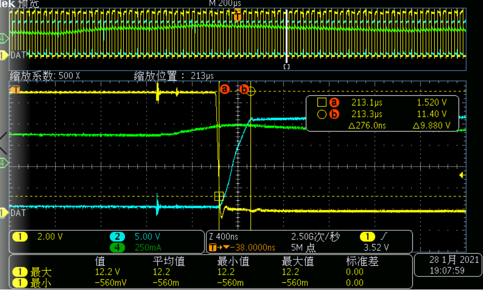

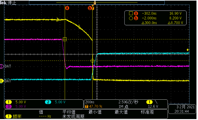

    -----I still can't understand why the High-Side MOS delay long time (about  delay 300ns) to close??
    as the waveform follows red line:
    -- YEL : High-Side MOS VDS      BLU: High-Side MOS VGS      GRN: Current to the Phase Coil   Pink: Low-Side MOS VGS
    #1: at 1 moment--High-Side VGS Voltage is Low ,but VDS also still low,  why  ? I think Vds should change to High rapidly ,
     (but from the waveform , you can see it rise from 1 moment to 2 moment , the period si about 300ns)
    as you referred , this time LS Diode catches, so Vds should change to Vds or more; so why?
    plz ~~

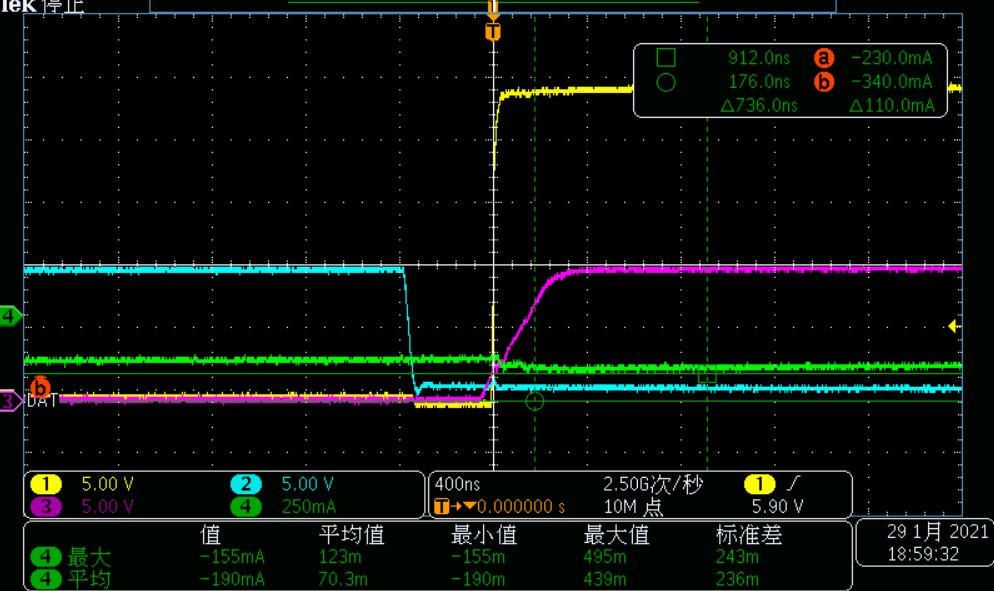

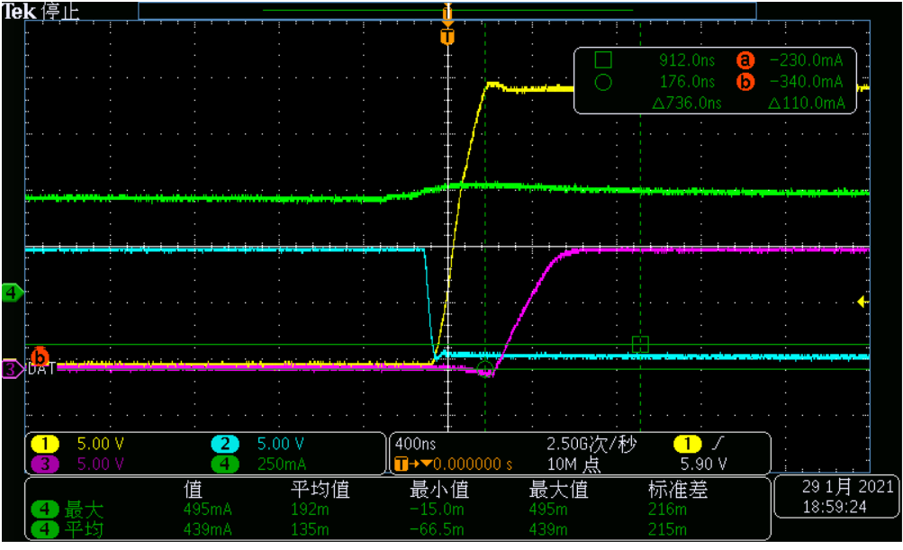

    ------- I also test the waveform as you show me
       - YEL : Low-Side MOS VDS    BLU:Low-Side MOS VGS      Pink: High-Side MOS VGS
    also have the same question:
    -when High-Side MOS VGS changed to Low, the Low-Side MOS VDS slowly change to Low , why ?
    I think it should change to Low rapidly,rather than delay 300ns;
    If you are not driving very much current into the motor, it could take some time for the low-side MOSFET body diode to move through reverse recovery.
    • You may want to try an experiment using CSD18533Q5A (P2P), since it has a much lower Qrr 68 nC and trr 40 ns. You can see if this reduces the delay time, which means the delay is related to the MOSFET reverse recovery.
    • You can try to drive higher current into the motor. Reverse recovery time depends on the current drive and if at higher current this delay time reduces, we can attribute it to the MOSFET reverse recovery.

    --I have tried to drive higher current into the motor,you are right,   the higher the current is ,the delay time will reduce;
    --but i still can't understand Reverse recovery time,  because I think when HS-MOS Closed  and LS-MOS closed, LS-diode catched,
     why this time is called Reverse recovery time ?
    I read the article about Reverse recovery time, it refers that  the diode is in its forward bias condition,  then one reverse  voltage  connected to the terminals of the diode,
    but in my case , At the beginning the diode  is in reverse condition , then in its forward bias condition,
    pls
    Your case is going in the reverse direction compared to the article. So the same process is followed but in the reverse direction.
    The diode is recovering from the reverse bias condition (going to the forward boas condition), and the diode requires some current & time to overcome the Qrr.
    In your case (image from your previous post below):
    • Current is flowing out of SHx into the motor
    • The low-side MOSFET & body diode start in the OFF state when the high-side MOSFET is ON.
    • The high-side MOSFET turns OFF, at this point the VDS voltage across the low-side MOSFET  and body diode is +24V
    • Since current needs to flow OUT of SHx into the motor, the low-side body diode needs to turn ON to conduct current
    • However, the low-side MOSFET body diode is starting with a reverse bias at 24V with no current flow
    • The body diode will then start to recover from the reverse bias condition and move towards the forward bias condition (this requires current to overcome the Qrr)
    • In your image below, the low-side MOSFET gate is turned ON before the reverse recovery is completed. The MOSFET starts to conduct before the body diode drops all the way to zero. Once the MOSFET turns ON, the VDS drops to about 0V.
    Matt
