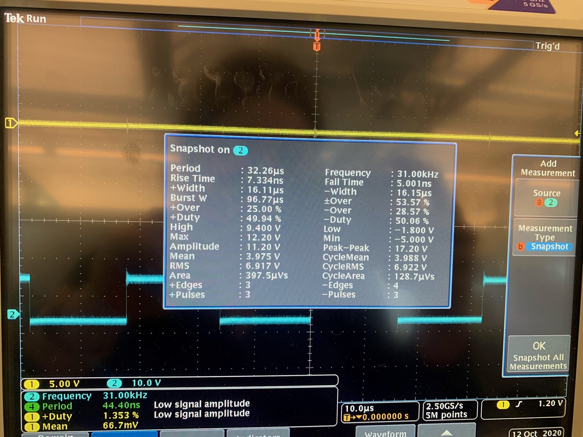

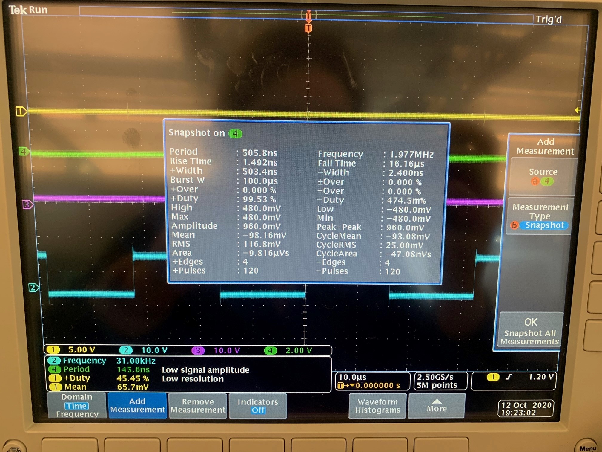

  • Hi Rachel,
    Thank you for posting to the motor drives forum.
    I have a couple questions:
    1. did you remove the 0ohm resistors (R15-R18)? those should be removed when connecting an external micro-controller.
    2. If the answer to (1) is yes, is the EK-TM4C1294XL properly outputting the PWM signal?
    3. If answer to (2) is yes, Is nENBL and RESET logic low? is the power supply (VM) on?
  • Hello Pablo,
    Here are the answers to your questions:
    1. Yes I did remove the 0ohm resistors.
    2. The EK-TM4C1294XL is outputting a PWM signal but I don't think its the correct PWM signal to trigger the DRV8803... or that is my assumption because there is no output.
    3. I do have nENBL and RESET floating (which should be fine because they have a pull-down resistor. VM is also powered on.
    Thank you,
    Rachel
  • Rachel,
    Thank you for the information.
    In regards to answer (2), what PWM frequency and duty cycle are you using for IN1, IN2, IN3, and IN4?
  • Pablo,
    The PWM frequency for IN1 and IN2 is set at the frequency of 31.25 kHz (as specified by the DRV8803 which I think is right?). For the duty cycle, I have the period defined, the pulse width set, and the output state-defined but I don't think I defined a duty cycle anywhere.
    Rachel
  • Rachel,
    What is the ON time and OFF time for both IN1 and IN2? If the ON time of the PWM signal is too short, the FETs in the H-bridge may not be fully turning on.
  • Pablo,
    Right now I have a delay after turning it on for about 200000 seconds. The code below is how I am generating my PWM wave. I am not quite sure how to accomplish the ON and OFF state that you are talking about.

  • IN1 is the yellow. IN2 is the blue.
    nFault is purple.
    Out1 is green.
    Out2 is yellow.
  • Hi Rachel,
    Here are my comments on the scope images:
    1. IN2 max voltage is 9.4V which is greater than the recommended max voltage for INx pins. This could damage the IC. I would suggest trying to run the EVM with the GUI to test if the IC is damaged.
      the value of IN1=1.3V which is greater than 0.6V which is the typical logic low voltage value specified in the datasheet. Assuming that no damage occurred from the high IN2 voltage, both IN1 and IN2 will be registered as logic HIGH by the IC which will placed OUT1 and OUT2 in a low state.
    1. Please retake the measurements but this time adjust the PWM signals until the min voltage is close to 0V and the maximum value to 3.3V

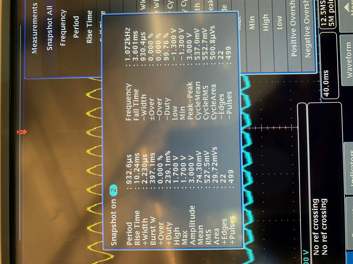

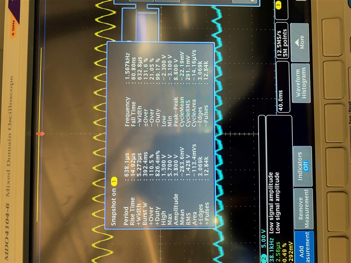

  • Hi Pablo,
    1. I retook the measurements with the changes you suggested, here are the results below.
    IN2
    OUT2
    2. I also did what you suggested and tried to use the GUI to test if the IC is damaged from the overvoltage. I have powered on the EVM board with an outside power source and I have also connected the EVM to my computer and I am using the GUI to I am reading IN1, IN2, OUT1, and OUT2. I have the jumper on for MCU power and no matter what I change on the GUI I am not getting any change on the scope, which to me means there are two causes of this. Either the IC is damaged, or I don't have the GUI and the EVM set up correctly.
  • Hi Rachel,
    1. You should be seeing some toggling at OUT2. This make me think that the device was damaged. I will try to recreate your set-up in the lab using the DRV8803EVM to see if I get the same results as you. If I do get the same results, then we'll have to figure out what is causing the problem.
    2. Did you solder in the 0Ω resistors when connecting EVM to GUI? If you did not, then that would explain why IN1 and IN2 are not changing. Even if the driver IC is damaged, IN1 and IN2 should be changing if the GUI and EVM are properly connected. Did you follow the steps on the user's guide?

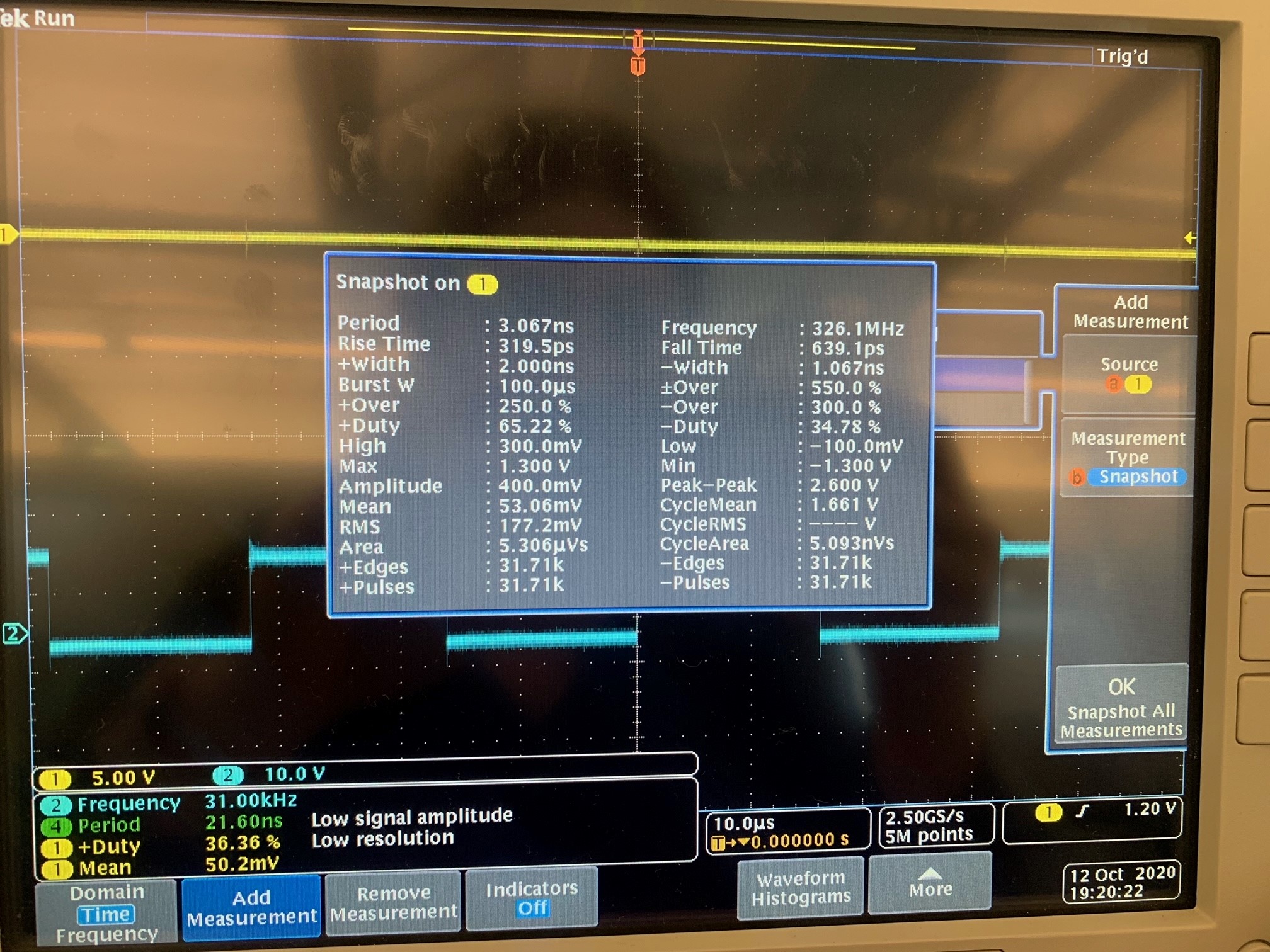

  • Pablo,
    Yes, I was able to retake the scope images, they are below:
    IN1 is the Blue
    Out1 is the Yellow
    Based on these images I think it's safe to assume that the IC is damaged.
    Let me know your thoughts.
    Thank you,
    Rachel
  • Hi Rachel,
    I believe the device probably is damaged, I suggest buying a new IC and replacing with damaged IC or getting a new EVM board. Once you have a new IC, try retaking the data again.
    I will close this thread for now but feel free to reply if you have any questions. If the thread is locked, you can ask a related question.
