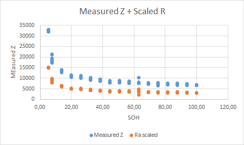

    About the Ra table:
    As specified: I measured the impedance and also both averages to determine how well the device is able to detect the EOS condition.
    In this case, the SOH was quite inaccurate. I will show you some plots to demonstrate this:
    Basically, the SOH was similar to the trend of the impedance but it was always offset. The EOS was detected when the battery marked 22%.

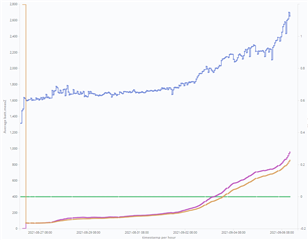

    This is the plot for the impedance and EOS Trent averages:

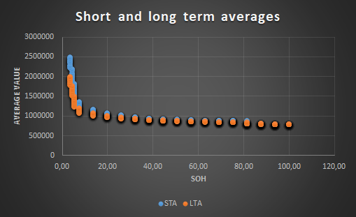

    This is the plot from both averages (With my predicted SOH):
    The EOS was successfully detected as predicted since the warning was given when voltage started dropping and my calculated SOH was around 7 to 10%, and the difference among them was around 20%.
    Right now I got the following Ra table and its comparison to the previous one (The new Ra table corresponds to MeasuredZ). What I did was just averaging the impedance value every 10 measurements on every step:
    I got problems by inserting Ra14 because BQstudio says the number is out of range, but since is the last step, I think any high number would fit there as well.
    I am repeating the test, but now, I am using the new Ra table to see if the SOH gets any improvement. However, it just counts down every time I send the start/stop commands. The only change I did was just adding the new values to the Ra Table through BQstudio. What do you think about the values, and why previously was not behaving like that?

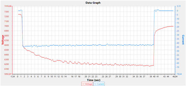

    Are you able to capture a scope plot of the battery voltage and current during the window the gauge is active? I do not know why SOH_MERRIT is on at this point.
    Eric Vos
  • Hi Mr. Vos,
    This is an example of how I am taking measurements.
    I Take 1 min 44 seconds long pulse for this purpose (don´t trust the timeline). Also, I make sure the battery OCV measured on the voltmeter would not overpass the OCV measured on the gauge.
    Also, what do you think about the Ra table obtained?

    Thank you for the pulse, I have feed the pulse shape back to my algorithm team to see if they can help determine why SOH_MERRIT is being set. I will hopefully have more information for you later this week.
    Please provide the RAW log file for how you did the Ra calculation. I will need to check your values. it seems off to me that the values decrease so much near the mid-end.

  • Fran,
    Since you are getting the SOHMerit flag still we cannot trust the value from the measuredZ reported. I see you have the data from the Average voltage of the pulse, but do you have the Raw data for each pulse like you provided in the image? Once we get the SOHMerit to not trigger we can use the gauge calculated values.
    Eric Vos
  • Brad,
    EOS mode of the bq35100 is not designed to report an accurate SOH as its primary objective. SOH is an estimation and a by-product of having the measured impedance correlated to a chemID. The EOS mode is designed to produce an EOS alert to know when the battery is near the end of life. The EOS alert does not need the modification to the Ra table being discussed in this thread. Even with a perfect ChemID match the impedance profile could be so flat that a good SOH estimation is not possible until the ending 20%. Due to the shape of the expected curve SOH accuracy should increase as you get near the end though.
    In regards to the pulse duration. This gauge's use case is for high amplitude short pulses, mainly for a radio transmission application. Under these circumstances a "learning load" is not needed. However adding a very controlled load to the system could only improve performance if the application can handle in increase power loss. The pulse in an application can also be too short. the gauge samples voltage and current every 8mSec when active. An 8mSec conversion is rather noisy so you will want at least a few samples to average out.
    Eric Vos
  • I'm not trying to measure SOH.
    However, you've written measuredZ and hence EOS isn't ok with SOH_ERROR and hence Wyatt wrote
    "SOH_MERIT should be labelled as EOS_MERIT because it looks at correlations with the resistance values calculated"
    effectively TI are now telling us the chip was concurrently designed to:
    1) measure a radio pulse ~ 1s (only) and
    2) turn on after 5 hours sleep with a fully relaxed battery
    so the marketing that this can be used in any system easily, seems to struggle unless that system sleeps a lot and then does almost no work other than transmit when it first wakes up.
    I really am trying to help TI realise why customers/prospective customers keep coming to the forum with the same fundamental issues. Its cost us a lot
    Apologies Fr4n if this doesnt help your immediate need in this thread.

  • Hi Mr. Vos
    I have all the raw data obtained through every measurement. I took around 10 samples per step of 5%, making 20 samples every 11% (counting the samples as part of the measurements). Do you need all the raw collected data?
    On the other hand, Since the problem is with the SOH_MERIT, and as you said several times that this will not prevent me from getting EOS detection, how can the MeasuredZ reported being affected by this error? I would agree if we talk about Scaled R, but I don´t see a correlation of the quality of the measuredZ values to the SOH_MERIT problem since as you pointed out, the problem might be that the device requires more than 15 seconds to calculate the data obtained.
    Would you like to inspect the raw data obtained for certain measurements? I still have every single sample logged. What would be useful for you to inspect?
    Thanks for the support at the moment. I will try to figure out if the EOS_MERIT error goes away.
  • Hi Mr. Vos.
    As suggested, I extended the "R data seconds" parameter from 15 to 60, 120 and 180 seconds and also even 10 minutes, and only sending a 1s pulse (sometimes even shorter), which basically, I just connect the two wires from the load resistors by hand and just "touch" both wires together (of course, after sending the START and before STOP commands). I have tried several times today and the SOH_MERIT error persists. This time, I am using just a single cell with a new evaluation board.
    I just wonder why there are several people around with this problem and until today nobody in the whole forum got a solution.
    Attached to this, there is the whole raw data obtained during my whole impedance tracking. on the folder LOG, you will find an excel document that compiles all the values into an excel sheet. Ra table 1 SAFT.zip
    I will just sum up my method:
    I have a single cell battery connected to a voltmeter and in series with an amperemeter. To connect it i just put the wires together.
    - Connect the power, observe the INITCOMP bit on, to be sure the device is ready.
    - Make sure the OCV voltage measured is equal, or higher than the value measured through a voltmeter connected to the battery terminals to prevent negative values of resistance.
    - Send the START_GAUGE command. Immediately, connect the load and provide a discharge of 50mA for only 1 second (maybe 2).
    - remove the load and send immediately the STOP_GAUGE command.
    Wait the amount of time set in R data seconds until I see the results. After giving the values and see the G_DONE bit on high, then I finish turning off the gauge.
    As you may see, my procedure is very straight forward and I don´t get any other error except SOH_MERIT.
    At this point, I don´t know what else to do.
  • Brad,
    This data looks exactly like I would expect to see. Where the test cutoff is right when you are reaching the exponential growth of the curve. The default parameter is 20% delta between the two trend lines. Based on the image it seems like you are already close and it is only a few more readings away. If you want it to trip quicker you can reduce the 20% to a lower value.
    Eric Vos
  • Fran,
    Thank you for this data it will take me a minute to process it all, but I will try to do so over the weekend.
