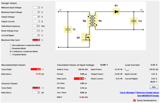

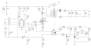

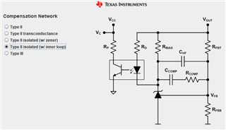

I would like to be able to use a circuit similar to PMP6963 with both the TPS40210 and TPS40211 devices. I understand there will need to be changes to the feedback\compensation passive components to make this work but I can't find any references as to how these values were developed for the PMP6963 design. I know this design is made around the 700mV reference inside the TPS40210 I would also like to get passive component values which will let me use the 260mV reference device, TPS40211. Thank you for your assistance.
