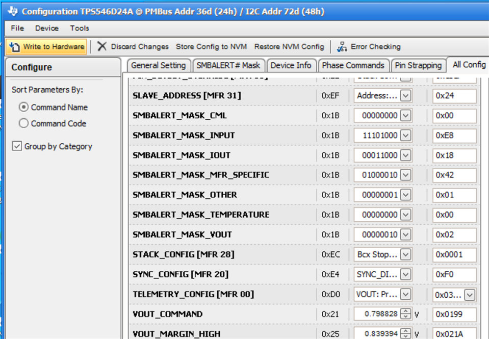

  • Although set to 400 mV output in the NVM, the power controller frequently defaults to 800 mV output. NVM values do not seem to stick.
    1) Did you update the PIN_DETECT_OVERRIDE (Command Code EEh) to clear the VOUT_COMMAND bit (bit 0) to switch VOUT programming from Pin Detection to NVM?
    2) After updating VOUT_MODE, VOUT_COMMAND, VOUT_SCALE_LOOP, VOUT_MIN and PIN_DETECT_OVERRIDE, did you also execute the STORE_USER_ALL command (Command Code 15h) to store the changes in to NVM for future power cycles?
    3) How is the VSEL pin terminated on the board?
    • How do I execute STORE_USER_ALL using the TI Fusion tool?
    • VSEL is connected to AGND through a 14.7 kΩ resistor, the default value on the EVM. I have not modified the EVM.

    I am glad that we were able to find the source of your issues and increasing the switching frequency to 550kHz addressed most of the issues you were having.  That is good news.
    Regarding your follow-up questions:
    In the FUSION GUI, after selecting a specific device, use the tabs on the lower left to navigate to the Configure View, and at the top of the screen you will see an option to "STORE Config to NVM" - clicking on that button will execute the STORE_USER_ALL command within the GUI.
    14.7kΩ to AGND with no resistor to BP1V5 is Resistor Code 6, which programs VOUT = 0.8V with VOUT_SCALE_LOOP = 0.5.  To change the VOUT setting via PMBus, including updating the VOUT_MODE for Exponent -12 and Absolute Mode, you will want to:
    1) Write VOUT_MODE to 14h (Note - VOUT_MODE is read-only while the converter is enabled.  To update it live, you will need to disable conversion with the EN/UVLO pin or the OPERATION Command)
    2) Write VOUT_SCALE_LOOP to 1.0  (Note - VOUT_SCALE_LOOP is read-only while the converter is enabled.  To update it live, you will need to disable conversion with the EN/UVLO pin or the OPERATION Command)
    3) At this point, use the "Write to Hardware" button on the upper left of the configuration window to update these two values to the TPS546D24A device.
    4) Update VOUT_COMMAND to the desired voltage. If you are entering HEX values, remember the HEX is now using exponent -12
    5)Update Pin Detect Override to change VOUT control to NVM on power-up
    6) Write these changes to hardware as Step #3
    7) Store the current PMBus settings to the NVM for future power on reset cycles.
