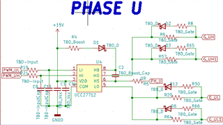

We are using UCC27712 for Our BLDC motor Driver,
but while testing we observer some strange Burst on high side MOSFET Gate pulse, due to which the output phase voltage is also behaving same
Requesting you to help on this
if You need more information regarding the Schematic and other thing, then that will share with you
Thanks in advance

    1. Can you provide a scope capture showing HO referenced to the HS node rather than ground? Either use a differential probe or use the scope's math function to subtract the switch node trace from the HO one you are showing. Can you also show LO simultaneously so we can see that the noise isn't caused by a slight shoot-through?
    2. Can you also get a capture of the bootstrap voltage (voltage from HB to HS)? This will help us tell if the issue is caused by the bootstrap circuit or not.
    3. Can you confirm if the schematic posted in the last thread is the same one we are working with here? What value of gate resistor are you currently using?
    4. Lastly, could you show the PCB layout of how the driver is connected to the FETs, as well as high-current paths? I believe you had a very high current system and that may be causing some ringing on the ground of the PCB.

  • Hi Alexander,
    1)Will share you the Waveform by the End of the Day
    2)Will also share the Waveform
    3)The Schematic is attached below the Rg=10R (R6,R57,R20,R64) and other are 0R
    4) I've attached the Layout image
  • Thank you Chaitanya,
    I do not see any issues in particular with the layout or schematic. It is hard to make out the details of the layout, but it looks like the power planes are a good size. Good luck with capturing the waveform. Also, have you seen any damage to FETs or devices due to this pulse?

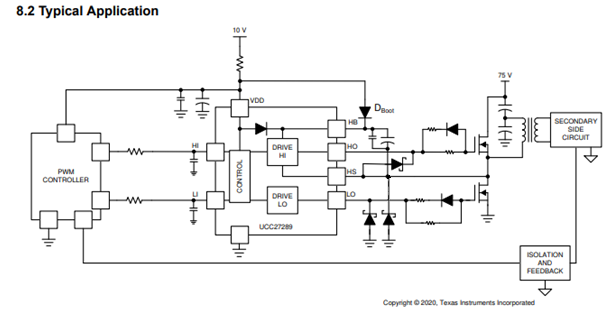

    This diagram is for a different part, but the same ideas apply. The Schottky diode from GND to HS will conduct if a negative voltage appears on HS, pulling it to ground. This should help reduce the negative spikes on HS. It should be placed extremely close to the driver to maximize effectiveness.
