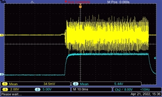

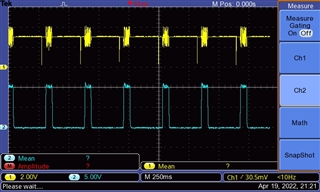

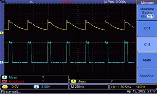

Hi guys,

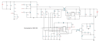

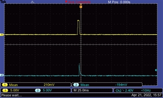

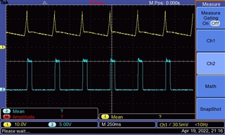

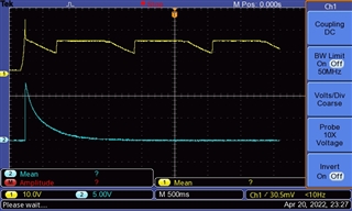

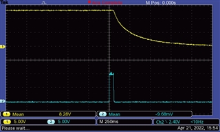

I am doing research towards efficiency in DC-DC converters. In this research, I'm designing a 160V-12V LLC converter for low powers (25W maximum) with the UCC256404 controller, I've added a screenshot of my circuit down bellow. My circuit is based on a WEbench generated design. The primary side of the transformer has 20 windings, auxiliary and both secondary windings have 3 windings. I'm monitoring some strange behavior: It seems like everything is switching on and off periodically.
Bellow, I've attached some screenshots of measurements I did. Note the quite large time axis width: it seems like everything is on for 50 ms, and then off again for around 250 ms. In the 50 ms on period, I'm having quite 'normal' behavior with my MOSFET drivers (high frequency switching, I did not include a screenshot of this). I've already looked over the data sheet, and made some experimental changes. From this I can conclude that the controller does not enter fault state (since the off period is not taking 1s, which would be the case for fault state according to data sheet), and that it is not an issue of the controller going into burst mode (I've tried my circuit with Rbw1 = 11 k and Rbw2 = 3.4 k, which should put it into mode 7, which turns off the burst mode). It seems like I'm having some problems with my VCC, since I'm not able to keep it at a constant. I do however not have a clue from where this problem is comming.
First picture is my design, then there are screenshots of different pins with the measured output. Next to that, at the BLK pin, I measure a constant of around 1V (which is expected, since I just input a source voltage of 160V)
ch1: VCC, ch2: Vout
ch1: RVCC, ch2: Vout
ch1: ISNS, ch2: Vout
ch1: VCR, ch2: Vout
ch1: BW, ch2: Vout
ch1: LL/SS , ch2: Vout
Arne
  • Hi Arne,
    Thanks for reaching out to us.
    The HV pin of the UCC25640x should be connected to rectified AC through 5kohm as given in below schematics :
    PFCLLCSREVM-034 User Guide (ti.com)
    UCC25640EVM-020 User Guide (Rev. B) (ti.com)
    If the HV pin of 404 doesn't see any zero crossing, it is going to inject the xcap discharge current at HV pin which will heat up the IC and may hit over temperature limit.
    If there is no rectified AC is available, you can use UCC256402 where there is no xcap discharge feature. In this case you can directly charge the VCC through DC bus input voltage of the LLC.
    Could you share the design calculator with me with the values used for your schematic.
    It would be easy for me to give suggestions if you share the design calculator (https://www.ti.com/lit/zip/sluc675 )
    Here is my observation from one of your waveforms:
    ch1: VCC, ch2: Vout
    Start up is initiated as soon as VCC charges to 26V. However, As soon as Converter starts switching, VCC voltage is getting reduced so fast. When the VCC hits VCCReStartJfet (9.65V), JFET turning on again to charge the VCC.
    Can you increase the VCC capacitance value see if that solves the issue?

  • Hello Manikanta,
    I think I've found the source of my problem: when I was measuring the auxiliary winding voltage, it only got as high as around 10V, which would make only around 9.5V after the diode, which is bellow the VCCReStartJFET. Therefor, I've added 2 windings to my auxiliary, making it 5 in total (aiming at 20V out of the auxiliary winding).
    However now I'm having a bigger problem: my controller is doing nothing at all: I've added the first screenshot of ch1=VCC and ch2=Vout. As you can see, VCC keeps on going periodically between around 15V and 10V (could be the 9.65V), Vout is doing nothing. I can confirm that VCC reaches the 26V at the start (second screenshot shows VCC on ch1 and RVCC at ch2 at the very start), but it only does this once. In case of fault, I think VCC would go back to 26V at restart, so I do not think I'm in fault state. I've also done measurements on the other pins (RVCC, HS, HO, LO, LL/SS) but they all seem to be zero. I'm not sure what to do next, do you have any suggestions?
    Arne
  • Hi Arne,
    RVCC zero means, its in the fault state. There wont be any switching. So the Output voltage will be zero.
    Please do the following steps:
    Directly connect external supply to the VCC pin using external power supply while keeping HV open.
    Increase Vcc to 26V initially and reduce it to 15V. And then increase the DC input to nominal value.
    And observe the waveforms at ISNS,LL/SS,Vout,FB pins and share them with me.

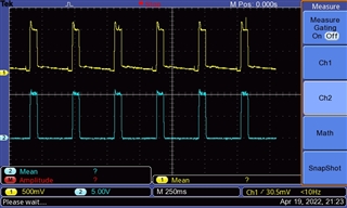

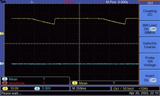

  • Hello Manikanta,
    Thank you for these Suggestions. I've disconnected HV from 160V, and left it floating. I'm now kickstarting my controller in the way you described it:
    I've already made small progress, but still not there yet.

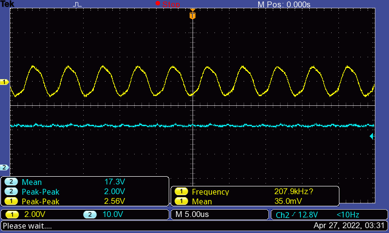

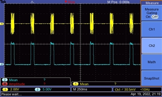

    A first thing was solved by changing the resistance values of the BW voltage divider. As I mentioned last time, I changed the windings at the auxiliary to 5, which made the voltage bigger at this winding. However with this, the BW bin becomes also bigger, getting over the OVP limit of 4V, making the controller going into fault.
    Now I've changed these values, BW does not exceed 4V anymore. The controller seems to switch on again now, for a period of around 65ms. I however still have the problem after this period of the FAULT state occuring: although I keep my 15V source at VCC, RVCC drops to 0V. The reason for the fault state occuring is not clear to me. Contrary to what we had previously, the controller doesn't restart again; although this is probably because I don't raise VCC to 26V anymore. Bellow, you can find some screenshots I made.
    BW & Vout
    ISNS & Vout
    LL/SS & Vout
    RVCC & Vout
    FB & Vout (not sure about this one, it seems like I screw up the signal by measuring it with my probe)
    VCR & Vout
    Also, here is my updated design file: 5658.UCC25640x Design Calculator Rev4.0.xlsx
    Arne
  • Hi Arne,
    The minimum frequency that controller can support is ~30kHz (calculated based on the maximum on time from datasheet). However, your design has much lower minimum frequency.
    Could you redesign the tank and make sure the minimum switching frequency is higher. Could you re-share the calculator with me.
    FYI, for a low power rating such as this case, flyback is recommended.
    Manikanta P

  • Hi Arne,
    Lets power up the control supply through external voltage for debugging purpose. So, you can remove the Auxiliary diode for now. We need to identify what's causing the controller to shut down?
    For debugging, keep only the lower resistance at the BW pin so that it will disable the OVP fault.
    Also keep a 100pf at ISNS pin to eliminate the noise.
    During normal operation, LL/SS pin should settle to 3.5V after startup. I don't see that in your waveforms.
    Please capture all the waveforms with these changes and share them with me.
    I can give you further suggestions based on the waveforms.
    Manikanta P

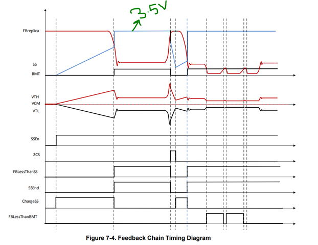

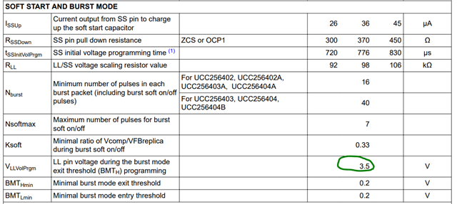

  • Hi Arne,
    LL/SS pin should be 3.5V during normal operation.
    I think controller is continuously hitting the ZCS in which case LL//SS pin will be less than 3.5V.
    Can you connect 1nF capacitor at the ISNS pin and see if that solve the issue. This would eliminate the noise in the ISNS sensing.
    Also if the tank gain is not sufficient, it would hit the ZCS limit.

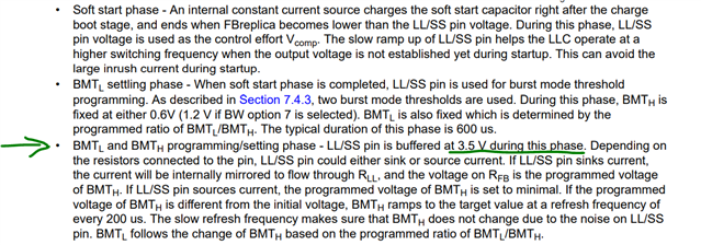

    It seems like I was a little bit too enthousiastic about my converter working last time. Although it is working at maximum load (Rload=6 ohm, Iout=2A), it is not working for any other load.
    When I make Rload higher (12 ohm) - so lowering Iout - the controller goes to fault state immediatelly. When I make Rload lower (4ohm) - so making Iout higher - I do have a DC output, but it is not 12V (it is around 9V). What I am doing now is powering my device via the auxiliarry winding via the following procedure:
    -apply 26V to VCC
    -lower it to 15V
    -apply 160V to input
    -disconnect the 15V from VCC
    I am not using burst mode (BW resistor option 7).
    I've tried to increase the upper capacitor of ISNS to 1nF, CISNS2 on my circuit, but this made the converter do nothing (even at Rload=6 ohm I had no output). I've also raised the lower capacitor at ISNS, CISNS1 on my circuit, to 100 pF. With this, there is no notable change comparing to when this was 3.3 pF.
    Also, regariding your last post: the datasheet always mentiones the 3.5V at LL/SS as being the voltage for this pin during BMTL-BMTH programming, but is this also the 'normal' operating voltage of this pin?
    Do you think some of this behavior has to do with hitting the ZCS limit? Via a current probe, I can measure the AC current going into the resonant tank, I've added it with my other screenshots bellow. These are my graphs at Rload = 6.ohm:

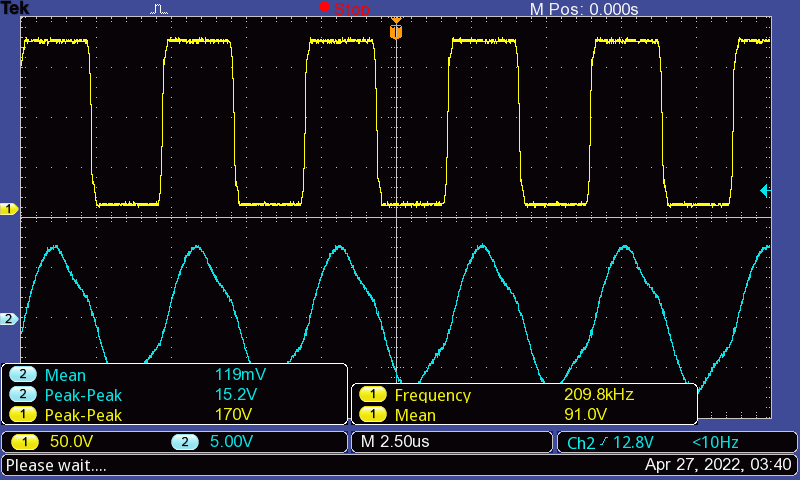

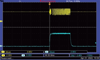

    BW & Vout
    ISNS & Vout
    LLSS & Vout
    VCR & Vout
    FB & Vout
    HS & Itank
    Is it normal for the frequency of the signals to be this high? Looking at the last screenshot, it is around 180 kHz, which way higher than what my calculation sheet mentioned.
    Arne
  • Hi Manikanta,
    I've now done some other measurements, but now with Rbwupper = 36k and Rbwlower = 5.1k. this makes the controller activate burst mode (option 6) and builds in some extra head room for the BW pin OVP (normally, if Vaux=20V, Vbw=2.5V, which is far from the 4V OVP threshold). With these values, I first tested with Rload=6ohm. This gave the same result as described in my previous post. Then I connected a 12 ohm Rload. Now, I did get a DC output voltage, but not of 12V (in a range of 15 to 18V). I think, the reason why this was not visible in my previous setting, is that the BW OVP would be triggered, triggering fault state. Hence, I think two options are possible:
    1) my secondary side feedback is not working
    2) the controller is ignoring this feedback due to internally avoiding ZCS. The data sheet states: When ZCS operation is detected, UCC25640x overrides the feedback signal and ramps up the switching frequency until non-capacitive operation is restored, after which the switching frequency is ramped back down at a rate determined by the soft-start capacitor until control has been handed back to the voltage control loop. This also goes allong with your findings in your last post, and explains why the frequency is this high. I hence think this latter option is what is happening.
    So assuming that I have indeed ZCS, and that the controller is reacting to this behavior by upping the switching frequency. Now is the question, how can I fix this? Do you have any quick suggestions, or is this a problem that requires a deeper analysis? If you are curious, these are my wave forms from the last situation. I had Rbwupper = 36k and Rbwlower = 5.1k, Rload = 12 ohm, Vout =  15V-18V
    BW & Vout
    ISNS & Vout
    LLSS & Vout
    VCR & Vout
    FB & Vout
    HS & Itank
    Arne
  • Hi Arne,
    Could you simulate the circuit using simplis model given in the UCC25640x product folder so that you can properly tune the feedback circuit. Also, you can reverify the tank design.
    LL/SS pin should be at 3.5V after startup. So from your waveforms, it seems converter operating in ZCS.

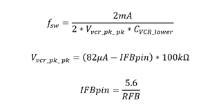

    You could run the converter in open loop and see if the converter is able to operate at the designed specs.
    The method to run the controller in open loop:
    Running UCC25640x open loop would require some modifications to the VCR circuitry as well as the FB pin to sink a constant current out of the FB pin. Since the FB pin is loosely regulated to ~5.6V, connecting a resistor (RFB) from FB to ground sinks a fixed current (somewhere between 0uA and 82uA). The amount of current would determine the switching thresholds (  for VCR). And then depopulate the top VCR capacitance so that charge control is completely disabled. Now the switching frequency is only dependent on the internal 2mA ramp current and the lower VCR capacitance ).
    Where IFBpin is the amount of current sunk out of the FB pin.
    Manikanta P

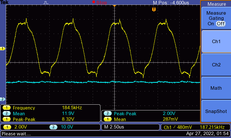

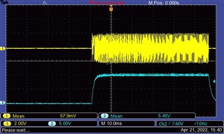

  • Hi Manikanta,
    Here is what I did: I removed my optocoupler, and added a resistor from feedback to ground. Then I also removed the upper capacitance of VCR.
    I made the following calculations (with my lower VCR capacitance being 9600 pF):
    minimum frequency = 34 kHz => VCR_p2p = 3.0547 => Ifb = 51.45µA => Rfb = 110 k
    maximum frequency = 76 kHz => VCR_p2p = 1.37 => Ifb = 68µA => Rfb = 82 k
    Then, took a look at the HS pin for both to take a look at the PWM frequency. However, the frequency for both resistors appeared to be 85 kHz. Because this was quite unexpected to me, I took some other resistors to test what the result would be for them. I tested 82k, 100k, 110k, 120k, 150k, 470k, 680k and 1100k; they all resulted in a frequency of 85kHz. I also used resistors 66k and 39k, they did not do anything: the converter stayed off, no PWM was visible.
    I also took a look at some current waves and the VCR pin, bellow you can find screenshots of some of them:
    ch1=HS and ch2=Vout for Rfb=110k:
    ch1=HS and ch2=Itank for Rfb=120k:
    ch1=HS and ch2=Itank for Rfb=82k:
    ch1=HS and ch2=Itank for Rfb=1100k:
    ch1=HS and ch2=VCR for Rfb=1100k:
    ch1=HS and ch2=VCR for Rfb=150k:
    I'm not quite sure what to make of these, and I'm not sure what to do next. I've ordered a new inductance to replace the series inductance that I have now (mentioned in last post), I hope that will solve some things. Please let me know if you have further ideas or suggestions!

  • Hi Arne,
    frequency should change when you change the resistors at the FB pin.
    Let me capture the waveforms with the EVM and get back to you.

    BTW, I will implement my new resonant inductor tomorrow, I'll keep you posted on that.
    Kind regards,
    Arne
  • Hi Arne,
    I was out of office for two days. I will send you open loop operation waveforms of the EVM by this friday. The output voltage is regulated in your simulation?
    Manikanta P
  • Hi Manikanta,
    Indeed, the output voltage is regulated in the simulation: when I change the output current, output voltage stays at 12V.
    Now, I've also swapped out my old series inductor with a new one on my actual circuit. The ZCS detection seems to keep on happening. I'm not sure what to do now. Thanks for your efforts to help me.
    Arne
