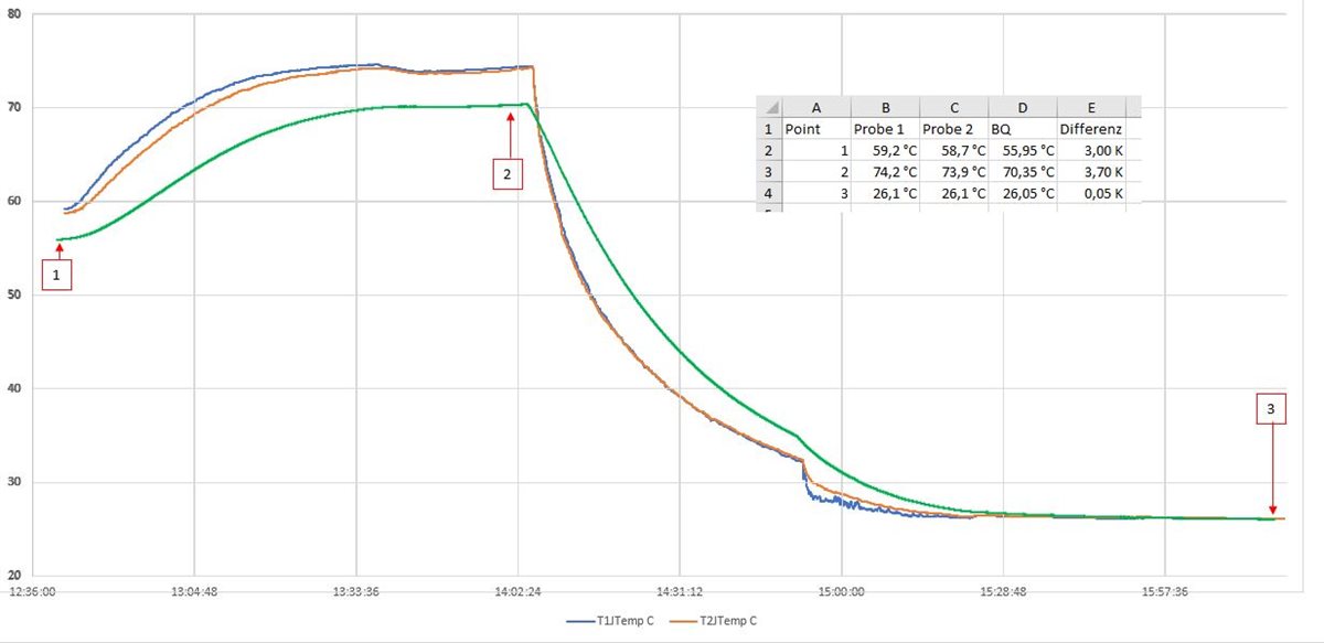

    I made a test with the internal Temperature sensor of the BQ and compared it with two J-Type Temperature probes which were glued to the outside of the battery pack. I started at 60°C, went up to 75°C and then let it cooldown to ambient temperature again. At the high temperatures there is a certain offset of 3 to 4 K and at room temperature the measurements are identical. Because of this I think the calibration is fine.
    The question now is can we improve the behavior by adjusting the characterization of the internal temperature sensor?

  • Hello Tobias,
    Using the specified Semitec product will be the simplest and recommended solution. Other than that, the best solution we can offer is a tool and associated document.
    Updating the thermal coefficients (internal and external) is a curve fitting exercise. There is no guarantee that it is achievable but here is the document and an Excel spreadsheet that you can use.

  • I agree with your assessment that the tolerance is bigger than the difference, so it may not be worth testing with A1 and A2 changed. Unfortunately there is no Excel sheet for the internal sensor. In general, the internal temperature sensor is slightly less accurate than using a Semitec 103AT.
    Do you have logs of the discharges that we can use to analyze the differences?

    after a few weeks of break, due to other projects using the climate chamber, I could go on with the testing. I compared three batteries on all three the same dfi-file was programmed. On the first battery Bat1 no adjustments were done, and the default settings of the internal temperature sensor was used. On the second battery Bat2 the average of the two external NTCs were used and on the third battery Bat3 the internal temperature Sensor with modified Coef 3 & 4 values was used.
    We know that this values normally shouldn’t be changed, but after comparing with the Excel file which is used for calculating the best values for Ext Coef 1…4 and seeing, that Int Coef 1 = Int Coef 2 = 0 it seemed that Int Coef 3 might be like with the ext Coef 3 the gain for linear part of the equation and Int Coef 4 the offset. So, we changed the Int Coef 3 to – 12483 to get a higher slope of the temperature function and the adjusted the Int Coef 4 to 617,1 to get the right offset at room temperature.
    After this changes at low temperatures, we get better results and at high temperatures it seems that we might have used a Int Coef 3 value which is a little high, so a value between the used -12483 and the default -11136 might be the solution.
    To come back to the original problem, we had with jumps in the SOC at low temperatures we will set up two batteries like Bat2 and two batteries like Bat3 and put them in the climate chamber tonight and see if still the problem is, that with the external NTC the SOC jumps and with the internal not. I hope that I have log files of this tomorrow.
    Can you give us any further information on the Int Coef1…4, Int Min AD and Int Max Temp? And if Int Max Temp must be set equal to Int Coef 4?
    Yours Tobias

  • Hello Tobias,
    There is a better match now except for at high temperature. The internal sensor details are not available.
    I believe that there is a 4th degree polynomial function. The offset is stored in Int Temp Offset and is updated during calibration of the sensor. Make sure to calibrate at room temperature first before running the test(making this comment because it seems like there was an attempt to adjust the offset using the coefficients). Hope this helps you get a better fit.
