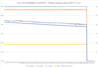

  • Hello Mr. Alex,
    Your advice helped me solve most of them. Thank you.
    For the charger IC I set the termination current from 200mA to 100mA  so that AvergeCurrent() absolutely go below the Taper Current ( = 200mA).
    Then, SOC change to 100%. 200mA is in Experiment 1 and 100mA in Experiment 2.
    There are two things I don't understand. I see "7.3.11 Charging and Charge Termination Indication" in the datesheet.
    In experiment 1, the first point is that the charge termination conditions seems to be met and the SOC would change 100%. But in fact, it was not.
    In Experiment 2, the second point is that the SOC could have reached 100% earlier than it actually did.
    Could you tell me that the condition in the datesheet seems to be different from actual one.

  • Hello Hirota-san,
    This FAQ should be helpful. It is written for the BQ40Z50, but the same logic applies. To clarify, the gauge does not actually use the averagecurrent() parameter for charge termination, but a 40s window rolling average current that it calculates itself once DSG=0. In the logs, I can see the difference between the current and the averagecurrent() is surprisingly large. The experiment that did not reach SOC=100% also did not reach charge termination. I believe this is because the average current the gauge is using for VCT is higher than the averagecurrent() reading.
    Notice the gray line doesn't fall below 200mA here, but does in the 100mA experiment.
    I'm not sure why the averagecurrent() is so far off from the actual average current. I'm not sure if it has to do with how you are setting up the experiment/logs. In any case, I can see that the learning cycle still isn't complete based on the logs (maxerror = 100%).  The SOC is not very accurate until the learning cycle is completed (hence the maxerror = 100%). So, I still think the best course of action would be to complete the learning cycle before trying to debug an SOC related issue.
    Let me know if you have any more questions/ need more details. I know the average current vs. averagecurrent() can be confusing.
