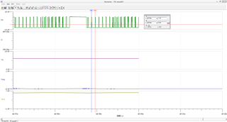

I designed the Split rail power supply with reference to the application report below.
SLVA369A (Create a Split-Rail Power Supply with a Wide Input Voltage Buck Regulator (Rev. A))
I simulated the designed circuit with Tina-TI, but it does not work as designed.
The switching frequency does not match the design.
RT was decided with reference to Equation 38 of SLVA369A.
RT (kΩ) = 206033 / 718kHz ^ 1.0888 ≒ 160kΩ
Design specification:
Vin: + 12V
Vopos: + 6V
Voneg: -6V
Iopos: 0.5A
Ioneg: 0.3A
Fsw: 718kHz
I attach the schematic and waveform.
Please teach me.TPS54160_split_rail.TSC

    (1) The load current is a typo. Actually, Iopos = 0.5A, Ioneg = 0.3A.
    (2) Follow the steps below to open the .tdr extension.
    tool-> Diagram window (Shift + Ctrl + D)
    When the diagram window opens, run File-> open to open the .tdr extension.
    Looking at the waveform, the switching frequency is about 1.1MHz. (Even though I set it to 718KHz)
    (3) About the case where the simulation hangs.
    Attach a capture of the analysis options.
    Although it is a Japanese version, I think the arrangement of items is the same as the English version.
    Simulation time is about 35ms. (It will be in a steady state in about 30ms.) I don't know why, but it will be longer than the SS time set by the capacitor connected to SS_TR.

    I am still having issues running your simulation files. I let the simulation run for several minutes without a computation progress.
    Slim198 runs fine, so something is either getting corrupted or the settings are incorrect.
    I am not aware of any issues with the Rt calculation. I confirmed via webench that Rt=162kOhm is for 710kHz switching frequency.
    If you could share a picture image of the simulation result, I can review those to confirm they are stable.
    My speculation is, you located a bug in the TINA model. I would trust Rt=162kOhm for 710kHz switching frequency.

    We will share the image of the simulation waveform.
    The simulation is horribly time consuming. I left it for 5 or 6 hours and it was finally over.

    >> My speculation is, you located a bug in the TINA model. I would trust Rt = 162kOhm for 710kHz switching frequency.
    → Is it better to verify the split rail on the actual machine rather than on the simulation?
    Thank you.
    Your simulation doesn't look stable. I believe the best path going forward is going through the theoretical calculations and then proceeding with bench evaluation. I completed the excel calculator for this design.
    It seems the compensation componets you calculated for are off from what the calculator suggests.
    i would recommend revising to the calculator suggestion. I can review your calculations if you feel differently.
    I attached the design calculator I worked up for this design.7674.SWIFTPOSNEG-CALC-v4.xls
