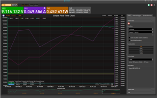

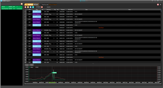

I designed a custom PCB using TPS65988EVM. I tested it. It worked fine but i am facing an issue while connecting a PD Wireless charger.

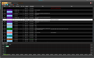

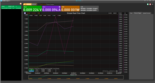

When  I connect that PD wireless charger with external adapter. It work fine but when i  connect it with custom board. No contract successful and power keep connecting and disconnecting.
Plz see the attached PJT file and wireless charger datasheet and let me know what i am missing.
HG-15W-TXS7.pdf
TPS65988_fixed.pjt
I need both PORTS as a source.
At one PORT, i will connect one sink device and on another PORT, i will connect wireless charger.

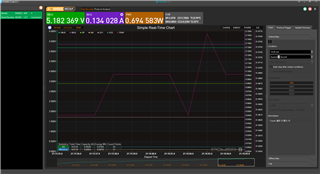

Also, PORT2 is only generating 5V contract and if i trigger other protocols. It stopped working.
