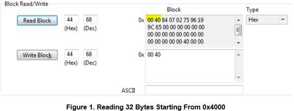

0x44 ManufacturerBlockAccess( I think this is the yellow part for the 16bit address of the Block access command)
How to tell the BQ78350 the red circle address in the SREC file(the higher bits of the address marked in RED circle in the SREC)?

     thanks for the document. but this does not clarify everything for me. Let me explain where I get stuck in the information I have until now.
    I have created A SREC file with BQ-studio. If I look at the file with an editor I see that the Header record is there Type S0 and that the rest of the file is Type S3 this is according to  Motorola SREC standard A format with an 32bits address.
    If i look at the document slua742.pdf  I see that the system is 16bits adress.
    In Figure 1 the starting address for a block read has been written to block command 0x44 using the Write
    Block button. Note the little endian notation where the address 0x4000 is written as 00 then 40.
    If i now look again in the begin of the file.SREC I see for example 00004000 that is the address 0x4000 and can be written to the TI with an Write-block-command and the following blocks looks the similar but if i look down in the file.SREC  I see for example 001043F3 this is more than the 16 bits used in the begin of the SREC and More then the 16 bits with the block write command of the document slua742.pdf
     Shirish, can you explain how to handele this en send this 32bits adress format to the Ti device BQ78350?
