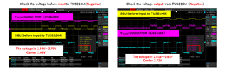

    The single-ended AUXN measurement uses different vertical scale per division, so I can't tell if there is an issue with the AUX itself.
    But with the common mode voltage being correct, then the SBU/AUX switch should work. It is a passive switch without any signal compensation. But 348mV differential peak to peak voltage is above the 270mV per the DP spec, is there an particular issue with the 348mV differential peak to peak voltage?

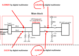

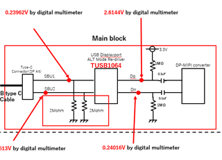

  • David-san
    I added the circuit diagram in ppt.
    and I key in the voltage for SBU1, 2 and AUX P and N which I measured by multimeter.
    please check it.
    [Problem] decrease the swing of AUX after pass through TUSB1064_rev3.pptx
    Do you have the 100k pullup/pulldown populated correctly on the TUSB1046 side? As you can see from the TUSB1064 common mode measurement, the common mode voltage is outside TUSB1064 spec.

  • Y.Nakanishi-san
    Source 100k pulldown on AUXP is a strong pulldown, so the expected voltage on AUXP is 0.3V. Source 100k pullup on AUXN is a strong pulldown, so expected voltage is 3V. But your measurement shows the AUXP/AUXN voltage does not meet the spec, this is why I ask if 100k pullup/pulldown is being properly populated.

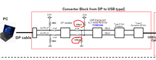

  • David-san
    thank you for your quick reply.
    as below figure,
    the 100kohm is in our converter block and it is after TUSB1046.( it is NOT TUSB1064)
    we asked TI member to review the circuit at that time.
    However, do I need to put 100kohm before or after TUSB1064?
    please give me advice.

    Your physical AUX implementation is correct.
    For TUSB1046,
    1. 100k pulldown on AUXP
    2. 100k pullup to 3.3V on AUXN
    For TUSB1064
    1. 1M pullup to 3.3V on AUXP
    2. 1M pulldown on AUXN
    But your AUXP/N measurement does not match with the AUX implementation. I would expect to see 0.3V on AUXP and 3V on AUXN. So you need to check whether the 100k is being populated correctly on the TUSB1046 side since 100k is a stronger resistor than the 1M resistor or you need to check your FLIP pin, make sure the FLIP pin is being driven correctly.

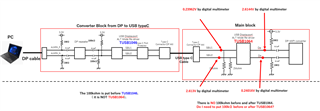

  • David-san
     sorry, too late my reply.
     because we took national holiday in Japan.
    could you tell me how to  check the 100kohm and FLIP pin?
    and you said below
    > For TUSB1064
    but I concern that we put 2Mohm pull down before TUSB1064.
    could you give me comment about 2Mohm pull down ?

  • Y.Nakanishi-san
    The 2MΩ pull-down resistors on SBU1 and SBU2 are representative of the leakage of ESD and EMI/RFI components including termination to ensure no floating nodes, and are intended to show compliance with zSBUTermination in USB Type-C r1.0.
    You have a stronger 100k pullup/pulldown on the source side (TUSB1046) while have weaker 1M pullup/pulldown on the sink side (TUSB1064). So the common mode voltage is mainly driven by the 100k pullup/pulldown resistors. Right now, your common mode voltage is not correct on AUXP/N per your multimeter measurement. You need to resolve it first. Once you resolve the common mode voltage issue, then you can check to if the AUX swing voltage is meeting the spec or not. The source needs to increase its AUX swing voltage if it is too low, I am no aware of another solution.
    You can measure the voltage on FLIP pin for both the normal and flip USB Type-C orientation, and you can visually check to see if 100k pullup/pulldown is populated on the source side.

    1. The common mode measurement between the multi-meter and scope does not align with each other. So you need to resolve the difference between the two measurements
    In your scope measurement,
    AUXP common mode voltage is around 0.12V but your multi-meter measurement shows 2.6144V.
    AUXN common mode voltage is around 2.72V but your multi-meter measurement shows 0.24016V.
    2. This particular scope measurement seems to show some noise issue with AUXN, can you double check and make sure it is a setup issue?
