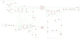

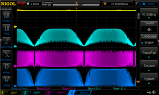

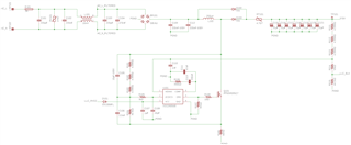

I have recently designed an AC-to-DC power supply (100-250VAC input, 18VDC 8A output) using the UCC28056B as a PFC boost converter and the UCC256404 and UCC24624 as a resonant LLC converter with synchronous rectifiers. See the schematic images below for details.
To design it, I used TI Power Designer and the IC datasheet information + Excel design tools (see the filled out versions posted below) as a baseline, as well as the provided SIMPLIS models and testbenches for tuning, simulation, and compensation loop design.
I have built a prototype of this design, starting with the UCC28056B PFC boost converter alone, which appeared to work correctly on its own (with an external VCC supply).
However, once I tested the complete prototype (with LLC converter, no output load applied), a few seconds after applying the input voltage (240VAC 50Hz), both LLC converter MOSFETs failed simultaneously, in a short-circuit mode (measured after the failure).
I measured the circuit before testing it, to ensure voltage divider values are correct and there were no short circuits or other previously identifiable problems.
I have no immediate clues as to what's wrong with my design to make such a failure happen and I don't know how I can test the circuit or figure out the problem without immediately destroying more components. Can you see anything wrong with my design? Do you have any hints for how I can fix my design to prevent such a failure from happening again?

  • Hi Alexander,
    Currently the gate resistance being used is very small. Please use the gate turn on and turn off resistors as shown below:
    I dont see any other issues with your schematic and the design calculator.

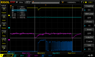

    However, I am encountering weird behaviour regarding the shared BLK voltage divider (used for the UCC28056B VOSNS pin, as well as the UCC256404 BLK pin).
    When I attempt to debug the circuit as you described, with the PFC controller unpowered (D101 removed), the BLK voltage only reaches ~0.5V, far below the start voltage. Since the resistor values are correct, I assume the unpowered PFC controller is pulling it down.
    When I replace D101 to power the PFC controller, the BLK voltage now rises to above 1.0V as expected, which allows switching to start - but the PFC controller appears to pull the voltage down regularly (at ~1kHz), seemingly causing the LLC controller to enter an input under-voltage fault state shortly after switching begins. After 1s, the controller resets, and the same pattern repeats.

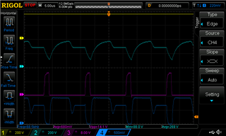

    I have attached an oscilloscope trace showing this situation.
    Channels are (in order 1-4, top to bottom): RVCC pin voltage, LLC input (bulk) voltage, BLK pin voltage, LO pin voltage.
    What could be causing such behaviour? Is the usage of a shared BLK voltage divider for PFC and LLC not possible here, or is there something else going wrong?
    Alexander Kharitonov
  • Hi Alexander,
    Could you depopulate the PFC controller as well and could you check whether LLC is working?
    Manikanta P

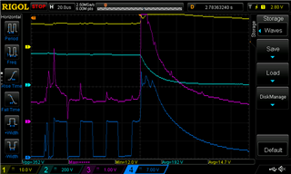

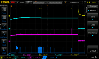

    I have depopulated the PFC controller and tested the LLC circuit again.
    First, I did a test run with a relatively high input voltage impedance - now, the BLK pin voltage followed the input voltage as expected, though the switching caused the input voltage to quickly fall below the turn-off threshold, stopping the switching again. So this appears to confirm my hypothesis that the PFC controller was interfering with the voltage divider.
    In an attempt to fix the input voltage drop, I supplied the LLC input voltage from a low-impedance regulated supply instead. This, however, quickly led to a similar failure to what I described in my very first post - both LLC MOSFETs failed in a short-circuit mode (gate, drain, source all shorted together).
    Excessive gate voltage should not have been a cause here, since I increased the gate resistances as you recommended (47R charge, 1R discharge through diode), and additionally protected each MOSFET gate with an 18V zener diode (MOSFET used is rated for 30V Vgs peak) - therefore I am unsure what could be causing this failure once again.
    I recorded the event with my oscilloscope, though I wasn't monitoring the ideal set of signals for failure analysis (as the failure was unexpected, of course). Still, maybe they can give some hints for the cause of the failure?
    The recorded channels are RVCC pin voltage, LLC input voltage, BLK pin voltage, and low-side MOSFET gate voltage (driven by LO pin, measured directly at MOSFET). Here is the full operation time-span, as well as the failure event itself:
    Do you have any idea about what could be happening here?
    My own hypothesis is that the MOSFETs failed first, which caused high voltage to be fed to the gate (clamped by the zener diode), feeding back through the controller to the RVCC supply, causing the spike visible there, until the input supply protection turned off the supply.
    However, this still does not explain the cause for the MOSFET failure itself.

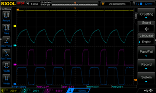

    I have replaced the PFC controller and started debugging the PFC section.

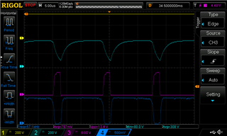

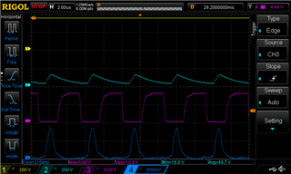

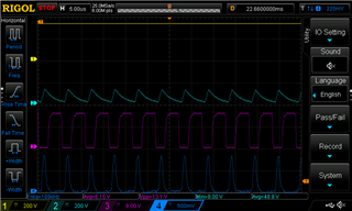

    At lower load, in DCM operation, the circuit appears to work without problems - here are some DCM waveforms.
    Channels are, in order 1-4, top to bottom: Output voltage, MOSFET VDS, MOSFET VGS, ZCD/CS Pin Voltage.
    Note that the VDS trace is not accurate due to impedance in my test setup - so the VDS rise/fall times appear much slower than they actually are. The ZCD/CS trace is much more accurate.

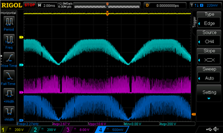

    However, at higher load, when the circuit is operating in CRM, something goes wrong. In particular, it operates as intended for multiple seconds, delivering regulated output power - but after a while, the audible noise of the circuit starts changing (a kind of hiss with rising frequency), and a few seconds later, the circuit fails. This time, it caused the controller and the MOSFET to fail (Drain-source short circuit), also destroying the current sense resistor.
    I tried to measure the behaviour of the circuit, both in the first few seconds of CRM operation, as well as once the audible noise starts changing. I don't really see anything wrong with this CRM operation (comparing with the waveforms given in the application note). Here are some traces, both an overview, and detail views at different AC input wave positions:
    So, in summary, the PFC circuit fails destructively in CRM operation, and I'm not sure what could be causing this. Do you have any ideas for what I could try in order to fix this?

  • Hello Alexander,
    In my experience, when a circuit appears to work "for a while" then begins to make noises and fails, it is usually (not always, but usually) a sign of some thermal runaway.  This happens often where a converter works fine for a long time or indefinitely at lighter loads, but then fails after a short time when the load is increased.
    In the case of your PFC, the three main components I suspect are the MOSFET Q101, output diode D103, or boost inductor L102.
    Please examine the heat dissipation capability of your design as regards these components.  D103 is an SMD and its pads may be too small to dissipate its losses.  Q101 is TO-220 and may need a suitable heatsink system.  L102 may be saturating if is is not properly designed for the application.
    If you have a thermal camera available, you can run your prototype at low power and see which components start to get hot.
    Gradual increase in load power can reveal the component which is getting hotter faster than the load is going up, and you can shut down the test before it runs away to destruction.
    I suggest that, until the PFC prototype is proven to operate reliably from 0 to 120% load over min to max input line voltages and frequencies, there is little point to attaching the LLC circuit and running them simultaneously.  Each converter should be debugged independently to verify expected operation before connecting them together.   Where signals may have to interconnect (such as RVVC and BLK), the PFC section can have test circuits which emulate how the LLC would drive those signals, and the LLC section can have test circuits which emulate how the PFC would load those signals.  Accurate emulation should include conditions where the PFC or LLC sections would be powered and unpowered.
