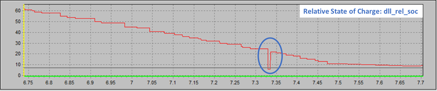

1. Relative SoC “jumps”: this is a common issue that we saw in another fuel gauge IC as well (bq20z45). In some cases, when reading the relative SoC parameter of the battery (dll_rel_soc), there are some “jumps”.

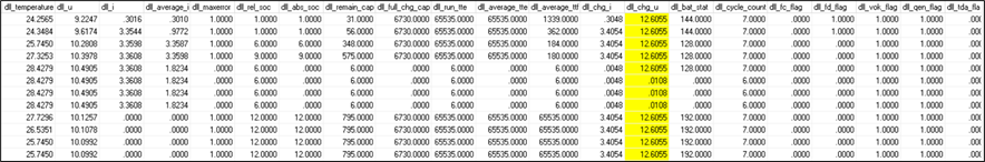

2. Charging voltage “jumps”: we also saw the same issue in the charging voltage parameter (dll_chg_u). This won’t be dangerous for the performance of the batteries, but it’s another symptom that the i2C communication could be failing.
3. Lots of values missing at some point: during the previous case, in which the charging voltage dropped to 0 apparently, many other parameters went down as well. The acquisition time is 5min, so as you can see there were probably 10-15min. in which the communication with the i2C failed for some kind of reason. This happened at 25ºC (inside a climatic chamber) and at the beginning of a charging process, which is quite uncommon in my opinion.

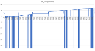

    Why does the data look with many discontinuity? You mentioned logging data every second, but the data log does not look continuous. It is hard to debug with this data.
    Why does temperature looks like this? Make sure temperature is stable during your tests. The only explanation is if communication is cutting too often.

  • Hi Jose,
    That's precisely what we would like to know. We don't understand why sometimes (not always) the data have so many discontinuities. It happens quite randomly, because all these tests were performed at the same time and in some cases these issues appear and sometimes not. That's exactly what we could like to clarify: where the problem comes from: is it our SMBus reading system or is it the fuel gauge IC under certain conditions?
    Regarding the logging sampling time, it's only 1s during the discharge processes. During the charging processes or during the waiting times that takes the climatic chamber to reach the required temperature (and the internal cells to also reach the temperature), the logging time is much longer.
