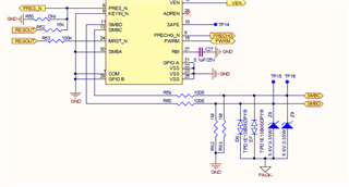

BQ78350-R1 IC Pin 11 (SMBD) & 13 (SMBC)  SMBUS lines communication failed with microcontroller.
SMBUS measure voltage at test points are  0V. and expected voltage is +3.3V.
power supply  VCC obtain from BQ7693006DBTR IC REG-OUT Pin.

    Are you using a custom board or our Evaluation Board (EVM)?
    In our EVM, the SMBus communication 3.3V comes from the EV2400 attached at J17. Figure 39 from the  bq76930 and bq76940 Evaluation Module
    The REGOUT from the BQ76930 monitor device is used to power VCC in the BQ78350. And, REGOUT is also used to power the I2C communications lines in the BQ76930.
    Please compare the communication connections directly with the BQ76930 EVM.

    If both custom boards are identical, what is failing? One of them has 3.3V when EV2400 is connected, the other one does not. Have you probed nearby the EV2400 port on both boards? Please do so and see where it fails.
    Jose Couso
  • Hello Jose,
    I have probed nearby the EV2400 port on both boards, we measure 3.3V when connected to custom BMS board.

    I am a bit confused. Where are you probing at? Please share schematic and setup if possible, and kindly point out where you are probing.
    Jose Couso
  • Hello Jose,
    I have shred a Schematic PDF file and setup JPG file for your references.
    I have probed at TP 15 & TP16 to measure 3.3V when connected to EV2400. also probed at EV2400 SMBus cable connector.
    Another  issue found at ALERT pin (TP 8) remains High -2.5V observed at TP 8. I prefer a BQ78350 and BQ76930 related documents and reference technical manual.
    In BQ78350 Technical references shows 3.6.3 AFE ALERT OVRD Protection section says the device can detect an external override signal.so that ALERT pin remains HIGH, please suggest solution to overcome this issue.24V_6S_BMS.pdf 24V_6S_BMS_3D_PCB.pdf
