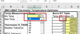

I have some questions/ request regarding the excel file :  "SLUC568"- bq78350 family Thermistor Coef Calculator.
1.The minimum temperature in this file that can be chose is -40 deg. and I need to calculate start from -55 deg. could you please advise how can I do it? (or maybe could you send me update Thermistor Coef Calculato file with this limit?)

  • Hello Yosef,
    1- The minimum operating temperature is -40C (see below). TI does not guarantee functionality below -40C.
    If you wish to proceed, you can edit cell F4 and changed to any temp. This will allow you to go below -40C.

  • Hello Jose ,
    Many thanks for the fast replay!
    I change the values as your advise.

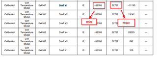

    The problem now is that when I try to load the new values to the BQ, it seems that the BQ has max allow value limit, and therefore it's not let me to load the new values of "a1" (request new value :-28356) and "a3"(request new value :-34015).

  • Hello Yosef,
    The temperature coefficients have a min and max values. See below.
    As long as the values are within range you can write directly to the memory location using Advanced Comm tab in BQStudio.
