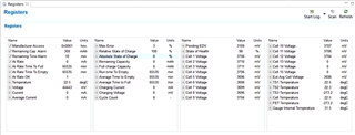

I have a few battery packs returned from the field With the RSOC set at 100% and ASOC set at 0% at the same time.

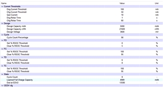

Some of the packs described above have a valid FCC of ~4900 mAh, some show FCC of 0 mAh.  In all cases the design capacity and the learned capacity in the Data Flash are as expected: 5000 mAh, ~4900 mAh respectively.
What might cause this to occur?

  • Hello Jose,
    The chem ID was matched. The packs were only a couple months old. In most cases, FCC dropped to 0 in use, but learned capacity was OK.
    Could a large load change FCC to 0 (maybe due to a large enough voltage drop), but leave learned capacity unchanged? I think there is a limit on how much learned capacity can change at any given cycle. Does the limit also apply to FCC?
    According to the tech reference guide SLUUBD3E (17.15, 17.16), ASOC is referenced to the design capacity and RSOC is referenced to the FCC. On these packs RSOC is 100% and ASOC 0%. Could these be reversed?
    Spencer

  • I will have to try and reproduce this in our lab. The customer was not running a log file while using the battery.
    My question was if FCC would update to 0 during use if a large current pulled the voltage down low enough to look like the end of discharge. Sorry, I wasn't very clear. Can FCC jump from ~4900 mAh to 0 mAh in one cycle?
    I think I get the ASOC vs RSOC readings. ASOC is 0% with respect to design capacity and remaining capacity is 0. RSOC is 100% with respect to FCC because 0 mAh remaining capacity is 100% of 0 mAh FCC.
