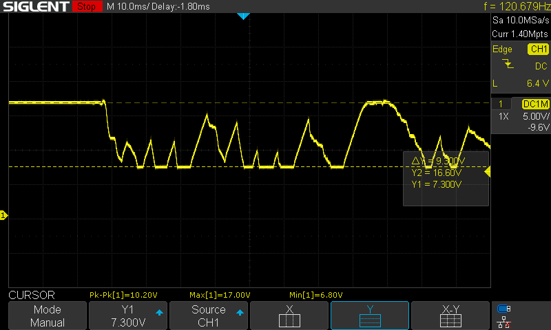

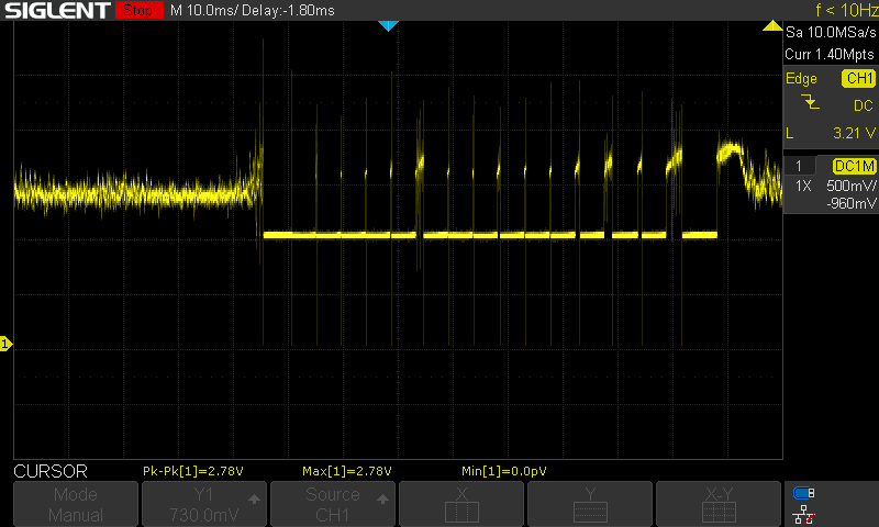

I'm having issues with this boost supply in two different instances
Issue #1:
Input is 3.5V to 4.2V
Output is 18V, with an expected load of 500mA
This power supply provides power to two LED light bars, with two channels each.  Each channel is 120mA for a total of 480mA.   I designed the circuit with a little extra buffer at 750mA.  The LED light bars are driven by a current sink (AL1792AFE-13 by Diodes, Inc) set to 120mA per channel.  When both light bars are turned on, they start to flicker and I see that the voltage rail collapses.  Here is the link to the simulation.  Below you can see a scope shot of the rail collapsing
https://drive.google.com/file/d/15bhAi8sB0FTvUNNfBODUVxSrG4kT-2Vg/view?usp=sharing

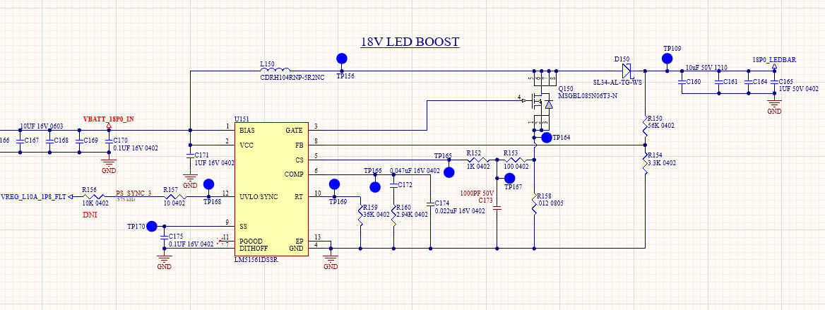

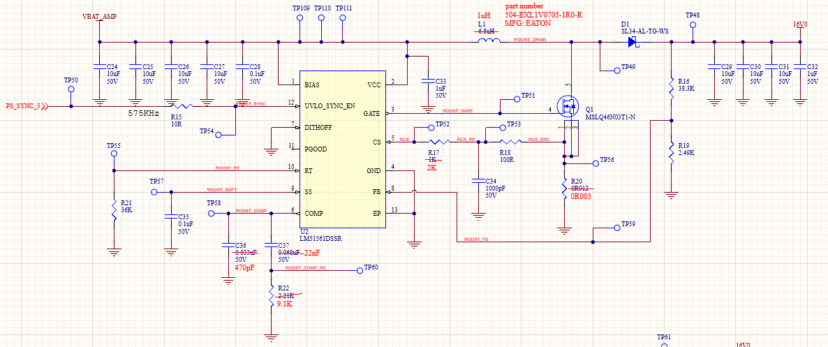

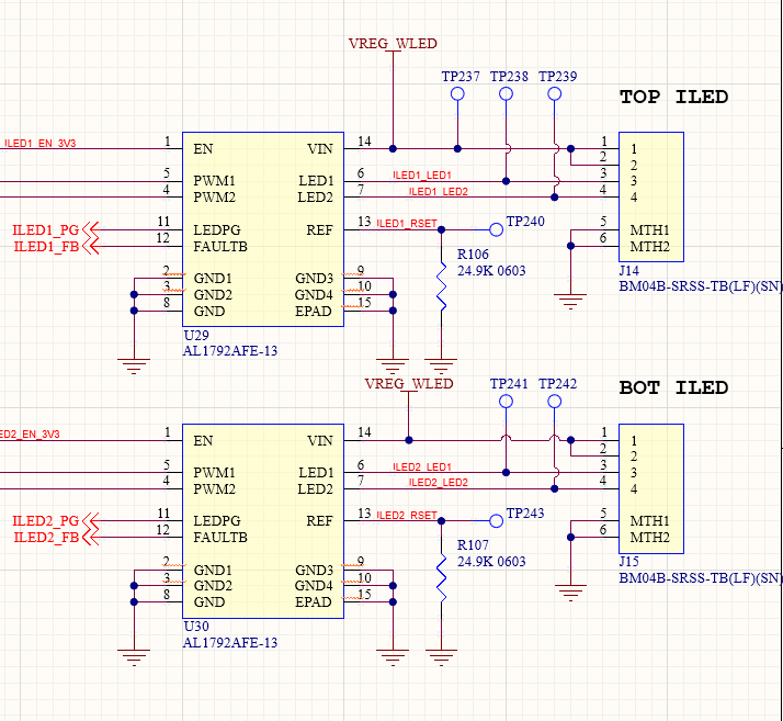

I'm also including a snippet of the circuit
Note: R156 is installed, PS_SYNC_3 is not present, and R158 has been changed to 9mOhm 1W per Webench recommendation.
https://drive.google.com/file/d/1_1B_9mfgefExwVK4zpFzaSLLeeAZnzoG/view?usp=sharing
https://drive.google.com/file/d/14d6bEUGmVTZCIQaIC-4G4rdiCealhirj/view?usp=sharing
I have used a benchtop supply to look at what the exact load from the LEDs are.  The load does not exceed 540mA.  I've played around with the design in webench and changed components to try and match the eval kit.  This does yield in good results.  The question remains though, why is the power supply which is designed for 750mA not able to handle a constant current load of 540mA?
Issue #2:
Input 3.5V to 4.2V
Output 16V, expected load of 630mA, designed for 750mA
This 16V rail goes on to power and amplifier for audio playback.  At full volume, the audio starts to clip and I can see that the voltage rail collapses by 10V or more.  See scope shot below:

Schematic:
drive.google.com/.../view
It turned out that there was some transient current of about 2A.  I redesigned the supply to accommodate for this.  The audio clipping is gone at full volume but I still see the rail collapse.
https://drive.google.com/file/d/1tGlATTDgEAlgP7x7d9vboZcmjt0KBpSP/view?usp=sharing
As an experiment, I spliced in the eval kit and still saw voltage rail collapse similar as shown above.  I went ahead and spliced in a benchtop power supply as well and that did not exhibit any voltage rail collapse.  Although the audio playback clipping is gone, seeing the rail collapse is concerning.

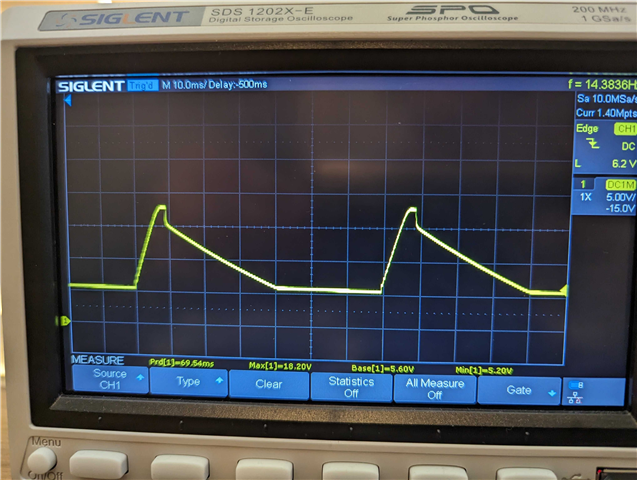

    I was having trouble uploading the images yesterday so I'll try again below.  Hope they come through:
    Issue #1:
    /resized-image/__size/320x240/__key/communityserver-discussions-components-files/196/8233.image-_2800_15_2900_.png

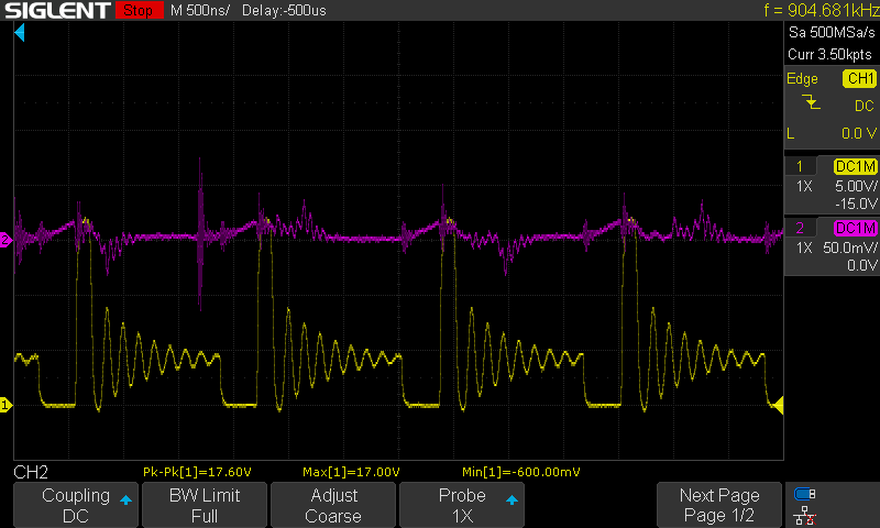

  • Let's try the images again
    Issue #1:

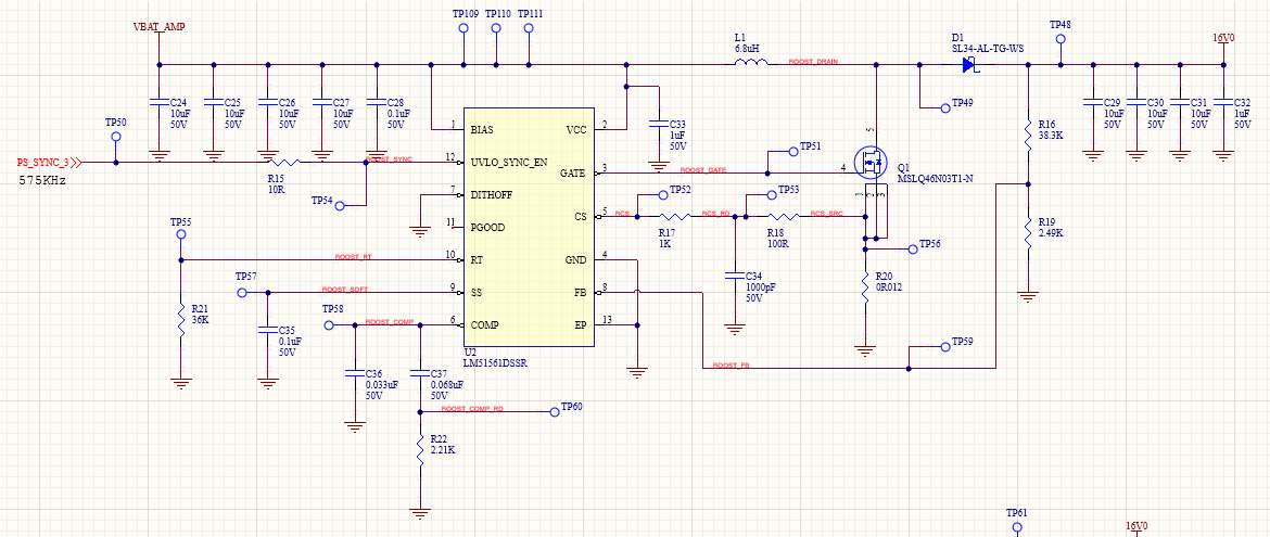

    Thanks for uploading the images again. I can read them now.
    I will look into your problem and come back to you at the mid of the week.
    Harry
  • Hello Omair,
    I reviewed the schematics for both of your applications and it seems, that in both cases the phase margin of the closed loop is very low.
    This can lead to an unstable loop. I recommend to first adjust the components of the compensation network according to the recommendations of the quickstart calculator. The phase margin should be around 60 degrees.

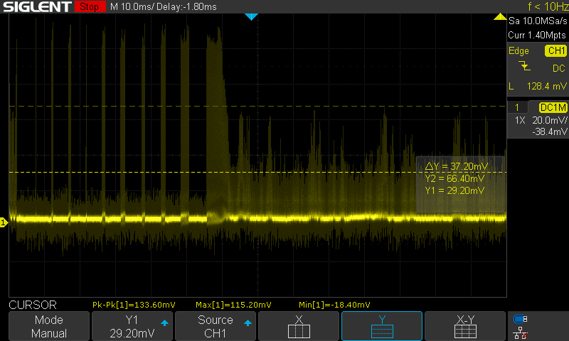

    Please see waveforms as requested:
    CS:
    COMP
    FB:

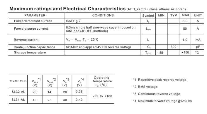

    Please also see specs for MOSFET and Diode
    MOSFET:
    2251.MOSFET.pdf
    Diode:

    Thanks for the scopeshots. Is the selected slope compensation resistor 2.1k as used in the calculator or 1k according to the schematic? Also the output capacitance and the feedback divider have different values in the spreadsheet compared to the schematic. However, these values will affect the gain and the phase.
    The controller might hit current limit, but can you please send a more zoomed in waveform of CS-pin? Also the RC-Filter at current sense (R18, C34) seems to big for the switching frequency. You can try to reduce C34.
    Moritz

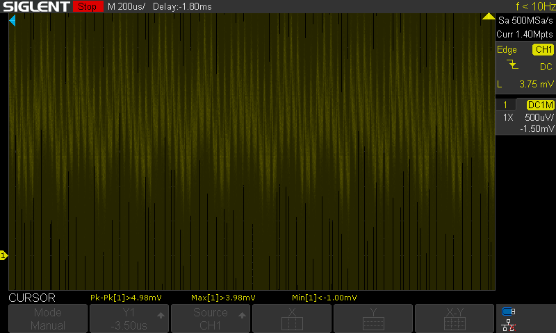

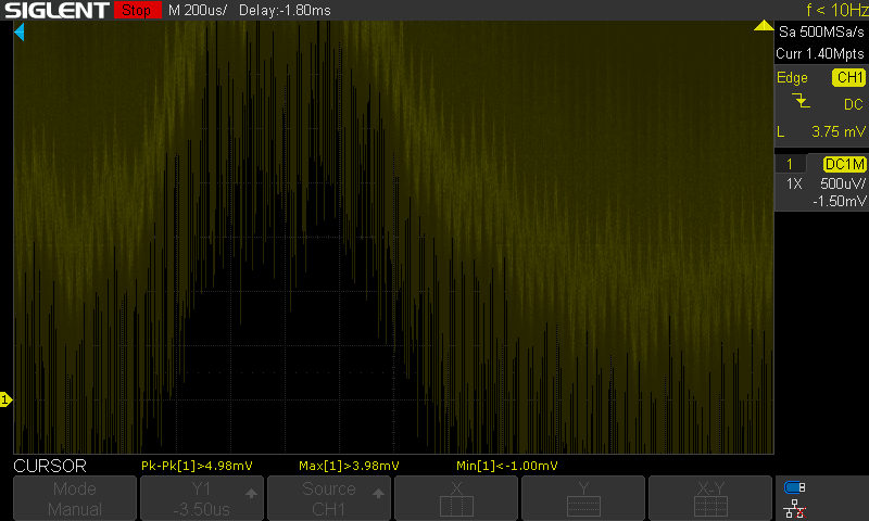

    Please see zoomed in shots of the CS pin.  I took a few different ones.
    I updated the feedback resistors which resulted in having to change Rcomp, Ccomp, and Chf.  I'm attaching an updated spreadsheet with all of the passives being used.
    I changed C34 from 1000pF to 470pF as well.
    The changes above resulted in the audio clipping symptom to return.
    16V Amp_v02.xlsx

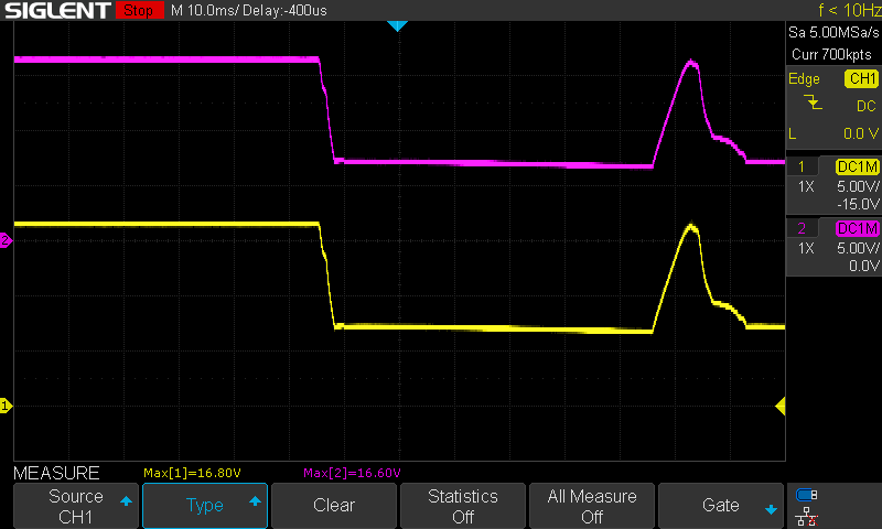

  • Hi Haroon,
    Please see attached scope shots.  Unfortunately I don't have a 4 channel scope so I took 2 captures at a time.  The first one is SW node on CH1 measured at TP49 and CS pin on CH2 measured at TP52.
    The ringing you see on the SW node exists even when there is no audio playing, meaning it has minimal load.  The scope shots were taken at full load
    The second scope shot below is Vout on CH1 measured at the cathode of D1 and Vload on CH1 captured at C41, which was the closest point to measure near the amplifier.

    I am very confused, I think you send out multiple Schematics and none of them matches the spreadsheet you have attached. Could you please check your excel sheet, it has wrong inductance and Rsense values, it is confusing. Could you please just keep one schematic file as pdf and one excel sheet instead of multiple ones.
    BR,
    Haroon

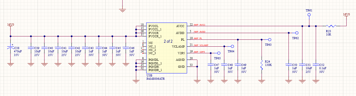

  • Hi Haroon,
    Since I'm changing components on my circuit board I am not updating the schematic.  The schematic that I originally attached is how the circuit was designed.  Since then I have been making incremental changes by swapping out components such as inductors, resistors and capacitors.  We were initially dealing with two separate issues.  Issue #1 was related to driving LED's which is resolved for the moment.  We have now been working on Issue #2, which is the audio amplifier.
    Below, I will post a modified schematic of the power supply circuit with components that have been changed based on the last Quickstart spreadsheet I posted.  Hopefully that will provide you with a clearer picture.  I will also post a schematic of the circuit for the amplifer.
    Power Supply Circuit:
    Audio Amplifier Circuit (load)
  • Hi Omair,
    Thank you for the clarification, so the schematics seems ok to me. My only concern would be for audio amplifier application you would need quite some output capacitance, especially at full volume, is it possible to increase that a bit? Since i see your output voltage collapsing as you have shown in one of the waveforms in your previous message, I think it could be due to this?
