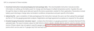

I'm trying to determine the CEDV coefficients for a BQ4050 CEDV Gas Gauge on a custom board (based on TI's reference design) with two Lithium Ion (LG INR18650-MJ1 3500mAh) cells placed in series.
I took several measurements for which the GPC report stated:
"Accuracy Error: Deviation is so high that it is most likely due to anomaly in the data"
reporting very large deviations > 50 % SOC error.
On the other hand, I have also received a positive GPC report with an acceptable deviation < 0.1 % SOC error.
I have picked two measurements for comparison one with this very high SOC error and the one with the low SOC error (please see attachment). I cannot see any significant differences between these two measurements.
What could cause this divergence in SOC error between these two measurements?

  • Hello Tom,
    The CEDV calculation tool is for temperature compensation. Results will not show the benefit of the tool unless the gauge and the battery are put in a chamber.
    For IVT data collection, please visit this app note Collecting IVT Data for Testing.
    If temperature is not a concern for the application, the gauge can be configured for fixed EDV points. Essentially, EDV0, EDV1, and EDV2 (usually at 7%). Please refer to section 6.4  End-of-Discharge Thresholds and Capacity Correction from TRM

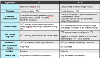

    1- Fixed EDV is for when temperature is stable and will not change much. CEDV increases the accuracy of the fuel gauge IC over temperature.
    2- You are correct, the learned FCC from previous cycle will determine when the cell reaches end of discharge. This end of discharge voltage varies with temperature.
    Have you checked our most recent gauging algorithm? Impedance Track? BQ40z50 which has the same hardware as BQ4050 uses impedance track.
    IT vs CEDV
    Jose Couso
