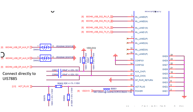

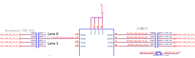

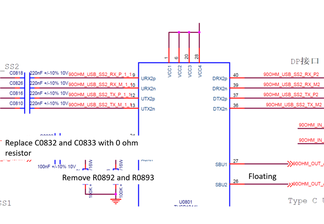

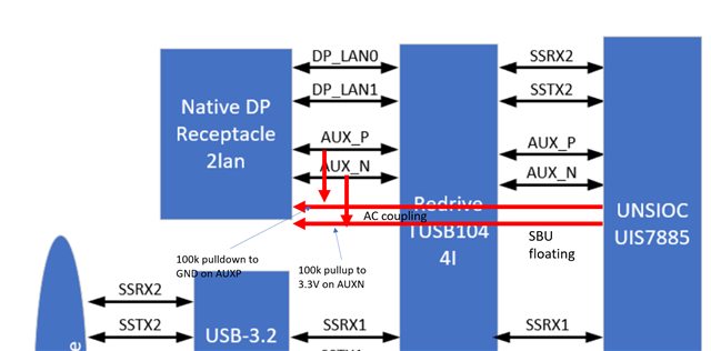

    We currently use TUSB1044 chip, and the circuit design is shown in the uploaded PDF document; The current phenomenon is that the SS1 channel can recognize USB3.2 normally. The SS2 channel cannot communicate the DP over Type function. Remove TUSB1044 chip connected to SS2 channel can be identified, how to use DP function normally.
    There are also the following issues to support:
1.Is the chip driving-free in GPIO mode?
2.The correctness of our circuit diagram needs to be verified. We have utilized the USB3.2+DP1.4 2lan mode.TUSB1044-reference design.pdf
