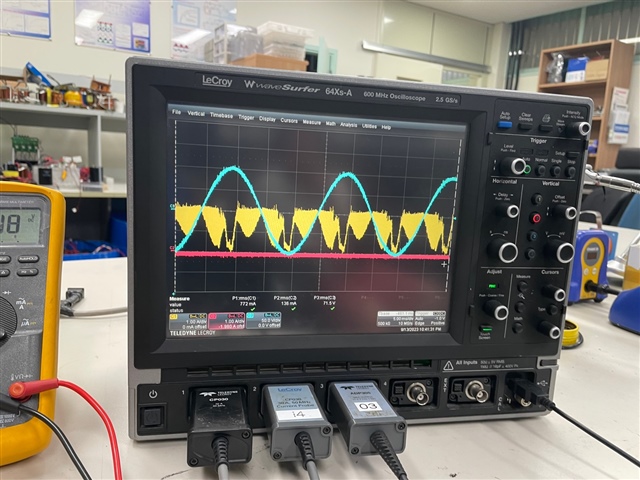

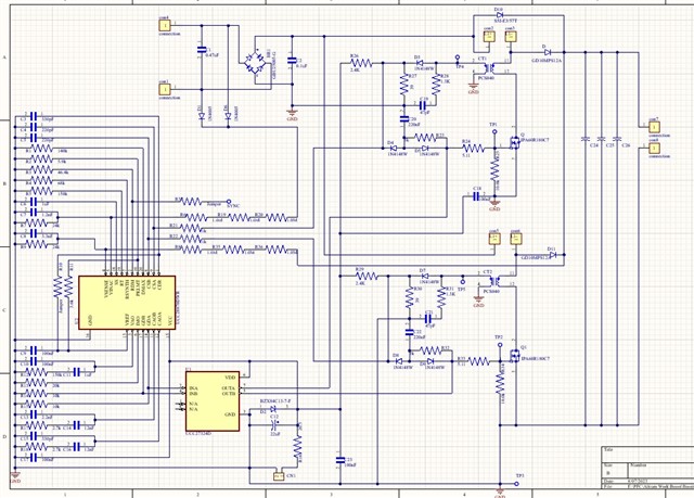

Dear Sir, I have designed the 1 KW Interleaved Boost PFC Converter using UCC28070. I am attaching the schematic of the design. I am facing the problem while running it. I am not been able to get the output voltage. While examining the outputs, I found that one of inductor current's waveform is not proper. I am attaching the picture of that inductor current. I swipe the inductors and also change them with new ones. But the shape of inductor 2's current on that phase is same. It goes to that shape when I was crossing 80 input voltage. On the other hand, Inductor 1's current is good at 80 Voltage.
Inductor 2 is making noise and flowing abrupt current as I shown in picture whenever I cross the 85 voltage. I am not been able to cross 85 Voltage to get output.
Please let me know what should I do.

    Since you have swapped inductors and tried new one with the same result, we can conclude that the inductor design is not the problem.
    Also, since one phase does work with the correct current wave-shape, we can infer that the non-working phase has some problem with the current control.
    Your schematic diagram image is fuzzy but I can see that the design of the two phases is symmetrical and if one side works we can expect the other side to work as well.
    Therefore I suggest that possibly the current sense in the phase with Inductor 2 (let us call it Phase 2) is not working correctly.
    It is possible that some component(s) on the board do not match the design on the schematic because of an assembly error.
    Please the orientation of the 1N4148 diodes located in the current-sense path of Phase 2.  Make sure they are installed with the correct polarity.
    If those are okay, check the values of the resistors and capacitors in that path.
    If the values are okay, check that the soldering of each component is good, and look for possible open-circuit (bad solder joint) or short-circuit (unwanted solder blob or piece of wire) at the component pads.

    As I mentioned before, the schematic image that you posted is fuzzy (low resolution) and so it difficult to read the component values.
    Please post a clear PDF file of your schematic diagram.  Also please post the UCC28070 Excel design tool that you filled out to obtain your component values.  What is your boost inductance value?

    I suspect UVLO shutdown on VCC.  On your schematic, it looks like you have a connector CN1 for an external voltage source, a resistor (I can't read the value), and a 22uF capacitor for VCC, plus a 13-V zener diode to clamp it.  I think UVLO can happen in 3 ways:
    a) Your external source is set to a low value of current limit, such as maybe 10mA or something like that.  Raise the current limit to 100mA.
    b) You set the source too close to UVLO threshold and have long thin wires from the source to the PFC board, that drops voltage when the VCC current rises.  Raise the VCC voltage to 15V, use at least 0.5mm diameter wire, use twisted pair and keep length short.  Remove the 13-V zener diode.
    c) The resistor between CN1 and C12 (22uF) has too high value and drops volts when VCC and gate-drive current rises.  Reduce the value of this resistor.

    Another way to reduce the current spike is to increase the offset voltage at the CSA and CSB inputs.  Your current sense resistors appear to be 39R.  The offset resistors to VCC (R26, R29) are 2.4K.  At VCC = 12V, the offset voltage should be 12V * 39R / 2439R = 192mV.  At VCC = 15V, the offset should be 240mV.  A higher offset voltage should reduce or eliminate the spikes but it will introduce a flat 0-A interval in the input current at the zero-crossing.

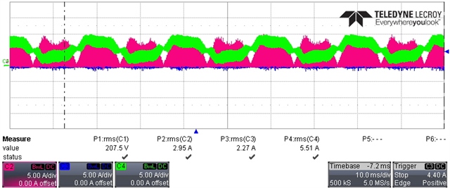

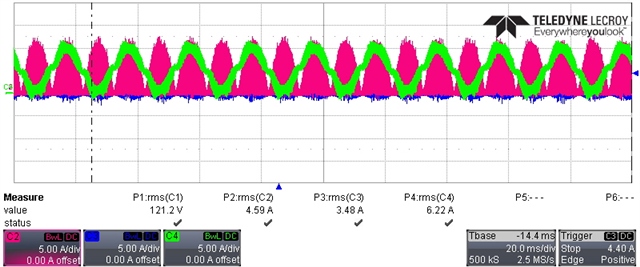

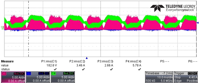

    Hope you are doing Well. Your above mentioned solution works well. Finally I got some results. I just recheck the voltage of VCC and component values and it works well. I also changed the Css to 2.2uF. peak inductor current problem is also solved. I will attach the Schematic of this project.
    Now I am facing the next problem. I am getting 370 output voltage with good waveforms of Input, Inductor L1 and Inductor L2 as shown in Figure but not getting the 390 output voltage. Whenever I crossed the 200 input voltage, My waveforms were not good and fluctuating output voltage. It again starts and restarts as shown in figure.
    At 120 Input Voltage At 120 Input Voltage
      At 180 Input Voltage
     At 210 Input Voltage
    After This Level, It starts fluctuation (starts and restart).

    For output voltage, your schematic shows R9=24k and R8+R35+R36=3000k, so regulating to 3V reference requires Vout to be 3V *(1+3000/24) = 378Vdc.
    Your 370V measurement is a little low.   Either R9 is higher than 24k or the upper resistance is lower than 3Meg.   If your pcb has solder flux on the surface, this residual flux may attract moisture and form an uncontrolled leakage path around high resistances, such as 3MR.
    Please make sure that your pcb surface is clean and free of flux and other contaminants to avoid reducing the effective resistance of high-R components.
    To get ~390Vdc, R9 should = 23.2kR.
    From your latest waveforms, it looks like the inductor currents are DCM (discontinuous conduction mode) even at 120Vrms input.
    At high output power, I would expect to see CCM, like here:
    Please verify that your boost inductance is 167uH.  You can use V/L = di/dt to verify;  ==>  Lb = (Vin * ton / delta-I ).
    Choose Vin at peak of the line (120Vrms = 170Vdc) and measure the change of inductor current (delta-I) during the MOSFET on-time (ton) in one switching cycle.
    If actual Lb is lower than expected, your ripple current will be higher and you may be hitting peak current limit at the higher input voltages.
    Also, the Rsyn value would be incorrect for the actual Lb value and this could result in a power limit.
