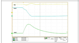

    I apologize for delay. Can you please perform the following tests. It will help in finding exact issue in the system.
    • Note: We need proper waveform with Vin, Vout and output current. In the oscilloscope, please add all these signals in same waveform and arrange them such that they don't overlap, and we can clearly observe the oscilloscope settings and signals. example waveform from datasheet is attached.
    • Test 1: Remove the R20 Net tie and test the Efuse alone to check the working of efuse alone.
    • Test 2: Now with dc-dc converter connected. You can solder some wire at the pads of R20 and use that wire to probe current. Provide all Vin, Vout and output current for efuse. Perform this for 2 values of SS_TR (pin 9) of TPS62130A. We will check the current signal for different soft start cap values for dc-dc converter.
    Test 1 will show if the device is fine or not and also will tell if the issue is caused due to high current required at startup of TPS62130A.
    Test 2 will help in correcting the issue if the issue is due to high current required at startup of TPS62130A.
    Example image from datasheet (all signals in same capture and they are not overlapping)
