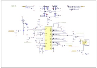

  • Hi Stefan,
    Here is the schematics. I hope this can be solved.
    Best Regards
    Terho
  • Hi Terho,
    thanks for sharing.
    I am not sure but it might be that the current sense circuit introduces a pole or zero into the compensation loop which leads to instabilities.
    This with increasing the cap on SS and making the current loop much slower gives also an indication to that.
    Analyzing the loop stability in constant current mode would be good.
    You can also try to make the response of the compensation slower with changing the RC to e.g. 1k and 120nF (sorry can not read the designator in the attached images - too low resolution) and check if this improves.
     Stefan
