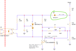

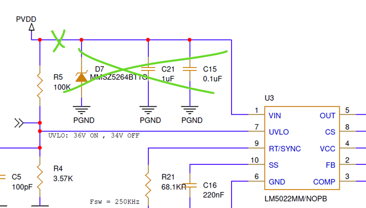

Hello, I need your assistance in reviewing the schematic design.
Specifically, I need you to focus on the TPS2373-3RGWT (U11) component, the 'Power Input Decision' block (Q4), and LM5022MM (U3).
The design should support the following options for power input:
1. DC external adapter only or POE only.
2. The DC external adapter should be prioritized over the POE input, and a seamless transition between them should be implemented.
2.1. When the DC adapter is connected, there should be no PSE detection for POE.
2.2. When both DC and POE are connected on power-up, the DC external adapter should be prioritized.
2.3. If DC and POE are connected and the DC adapter is disconnected, there should be a seamless transition to POE.
Please let me know if you need any further information.
Thank you
