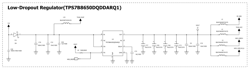

Dear TI experts,
My customer made their schematic with TPS7B8650-Q1. Could you review this schematic?

Hi Chase,
This looks good. NC pin 2 and pin 7 can be connected to GND for improved thermal performance if desired.
I'm not sure what the expected maximum and nominal load are, so the customer should double-check that for any potential power dissipation / thermal concerns. But based on the loads listed, I wouldn't expect there to be any issues. Let me know if any support is needed checking power dissipation.
