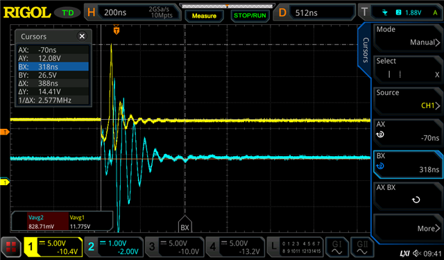

  • Youhao,
    Here is a scope trace of the FB pin, we have tried multiple boards and experience the same issue on all of them.
    Adam
  • Hi Adam,
    Thank you for the info.  May I assume CH1 is  FB voltage, and CH2 Vout?  According to  your schematic, FB produced by a resistor divider hence VFB is a fixed proportion of Vout.  How could it jumps up?  Could you trace the signal on your board and see if there is a hidden PCB error?
    Youhao
  • Youhao,
    We also tried the board with no resistors (fixed output of 5v) and we get the same result.
    Adam
  • Hi Adam,
    Sorry to hear but by same do you mean FB also jumps up like shown in above scope picture?  I am referring to the yellow trace. Is it FB?
    Youhao
  • I am wondering if the yellow trace in your scope picture is FB.  Could you confirm?
  • The yellow trace is FB yes, and blue is the output of the inductor as follows:
