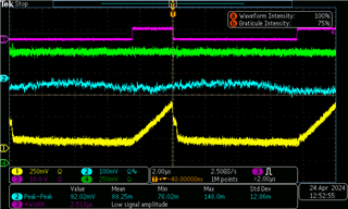

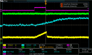

I am currently testing using this PWM in a Buck Converter design. In my design, I have chosen to include slope compensation on top of the current signal external to the PWM chip. I've done this because I would like slope compensation included even when the current limit is encountered.
Even though I have included (what should be) sufficient slope compensation to the current signal before it enters the chip, I see subharmonic oscillations at duty cycles near 50%, and see what appears to intermittent, sharp dips in impedance at the CS_ILIM pin (in green, where the current sum waveform has rectangular "bites" taken out of it).
I have tried a range of RSC values for the internal slope compensation, ranging from almost no slope compensation (as none should actually be required, RSC=10M) up to approximately 2x m (.068V/us, RSC=562k).
I always seem to get at least a little subharmonic oscillation accompanied by the weird voltage dip at CS_ILIM (for DC near 50%)
Any light you can shed on this is appreciated. Thanks,
CHAD
Below:
CH1 YELLOW: CST output (prior to summation)
CH2 BLUE: Slope Compensation Ramp (prior to summation)
CH3 MAGENTA: OUTA
CH4 GREEN: CS_ILIM signal (1:1,50% summation of CST and CS Ramp)

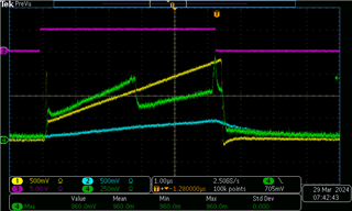

  • Thanks Daniel,

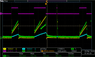

    After doing some more testing, I noticed that the strange CS_ILIM voltage jumps also was occurring well below 50%DC (further cementing that this is not a slope compensation issue). That said, adjusting the RSC does appear to have an effect on this anomaly.
    Below is a capture at approx. 30%DC (still closed loop) with what appears to be a voltage step being induced on CS_ILIM. (In this shot CH3 MAGENTA is COMP voltage, roughly indicating where the CS_ILIM signal should intersect and end the OUTA pulse).
    I proceeded to disconnect the CS_ILIM pin to observe the current and summation waveforms in an open loop configuration. (See below). I ran the open loop configuration at about 30%DC and got completely clean waveforms. Notice also that the green summation waveform lacks the "pull-down" that was apparent (presumably from CS_ILIM pin) at the leading & tailing edges above.
    It certainly appears like the CS_ILIM uA discharge is being activated (at the correct time judging from the first capture) but without OUTA actually turning off (if that is a possibility).
    I notice on the second capture that there are some small transients on the green sum waveform that line up OUTA transitions (but not the subsequent delayed FET transitions), but that may be probe crosstalk.
    Thanks again for any input you can provide,
    Chad

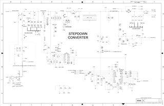

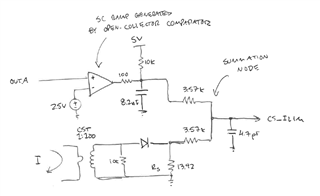

  • Sure Daniel,
    See schematic below. The ramp generator (comparator) is drawn in, as that is a part of the circuit that has been white-wired in during development.
  • Hey Chad,
    Is the LEB resistor R221 correct?
    That is well higher than anything I have seen for that resistor.
    Could you try a ~10-100 kOhm or some such value?
    Those are values we test as per the electrical characteristics.
    Daniel
  • Daniel,
    Yes the RLEB resistor (R221) is currently selected at 432k. This is above the datasheet recommended maximum of 300k. I had arrived at the 432k value after our conversation here, and determined experimentally that the 432k value resulted in a LEB of 420ns (which was desired at the time).
    Per your suggestion (and because that large LEB is not strictly necessary due to the current filtering configuration) I have reduced the RLEB to 100k. The CS_ILIM glitch persists (see below).
    Noticeable now is that the Leading Edge spike is now unaffected, whereas before it looked like CS_ILIM was suppressing it (plausibly expected behavior during LEB). Perhaps there is a clue in this: before adding the new summation circuit, with its increased impedance in the signal path to CS_ILIM, there was not observable suppression at the leading edge (I was only able to confirm LEB via the method described in the linked discussion). Perhaps this increased impedance is playing a role in "tricking" the decision-making and turning on the uA discharge but without terminating the OUTA pulse? [It appears from the capture below (and has been consistent in my testing so far) that the point where the glitch occurs is where the OUTA pulse should have been terminated.]
    Chad

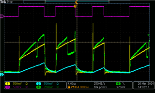

  • Hi Daniel,
    I had a chance to replace the TPS7H5001 chip (to rule out damage) and the anomaly still occurs.
    An interesting note is that is happens very consistently at low loads (for instance, the rogue pulse occurs right at about 2.5kHz with a light load of approx. 0.25A). At higher output levels, it will still occur, but much more spuriously, maybe only once or a few times per minute.
    Below the converter is running with output current approx. 0.75A:
    CH1 YELLOW: CS_ILIM
    CH2 BLUE: VOUT
    CH3 MAGENTA: OUTA
    CH4 GREEN: COMP
    As mentioned before, it looks like at the decision point where CS_ILIM = COMP/2, the micro-amp drain response turns on (puling down on the CS_ILIM signa), but the pulse does not terminate. Then the CS_ILIM plows right on through the COMP/2 signal, again without terminating the pulse. It's not obvious what causes the pulse to terminate, but it appears to be right around 50% duty cycle (this has been observed for previous rogue pulses as well).
    I will take a look at the VLDO rail for noise and look at OUTB as well to look for strange behavior.
    Chad

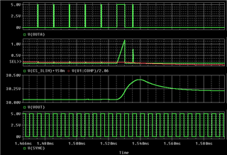

    Pspice simulation:
  • Hey Chad,
    Yes we will need some time to investigate this.
    The problem may simply be the way the current sense is done then, because how you did the current sense is something that was never tested with the part.
    If the issue is showing up in PSPICE I would be interested in looking into it there because thats a bit easier to test.
    See attached for how to share the files.
    https://e2e.ti.com/support/tools/simulation-hardware-system-design-tools-group/sim-hw-system-design/f/simulation-hardware-system-design-tools-forum/969692/faq-pspice-for-ti-how-do-i-share-pspice-for-ti-projects#:~:text=The%20best%20way%20to%20share,following%20checkboxes%2C%20then%20click%20OK.
    Daniel

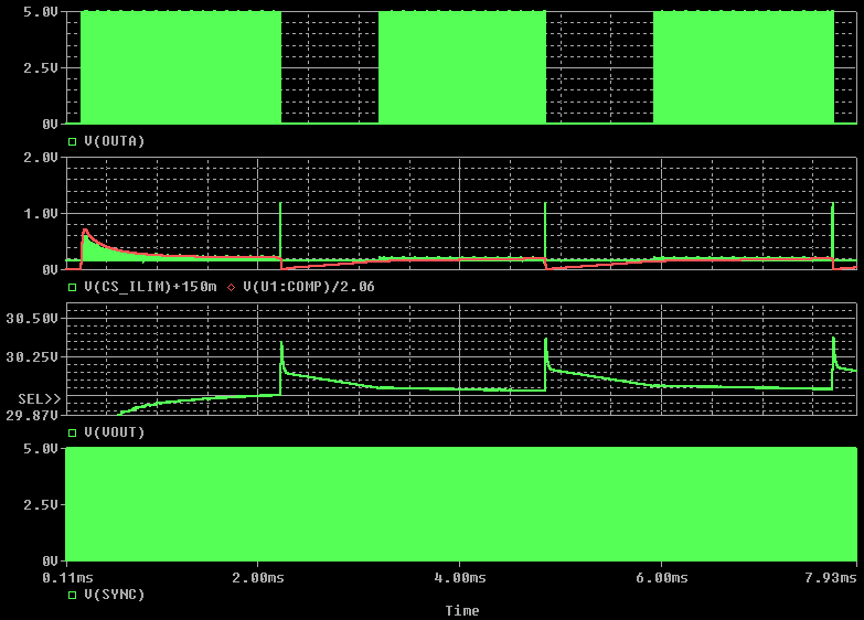

  • Daniel,
    I actually reverted the current sense scheme to the previous (simple, filtered current sense transformer) design and the issue still occurs. Similarly, the Pspice simulation that exhibits the same behavior is without an external slope compensation or summing circuit. So I'm not convinced that its my variation on current sense that is causing this.
    For some reason I'm not able to archive the Pspice project without Pspice crashing. However, it's not a terribly complex schematic (see below, it's a modification of the Pspice Buck project available for download from the TI website).
    The rogue pulse seems to occur right around when the COMP/2 signal approaches 200mV (from above or below), not sure if that's a clue. The behavior seen in the simulation is remarkably similar to what is observed in the lab.
    -Chad

  • Hey Chad,
    I have confirmed that the reason you see the issue in the model is because of the revision of the model you are using.
    We were able to recreate your issue in Rev (B) of the model, but not Rev (C)
    The update from RevB to Rev C fixed a 20 ns mismatch between two internal clocks.
    As to how this relates to your issue in lab, it would relate back to noise in the set-up.
    Our thoughts would be that noise could possibly cause a similar issue.
    Daniel
