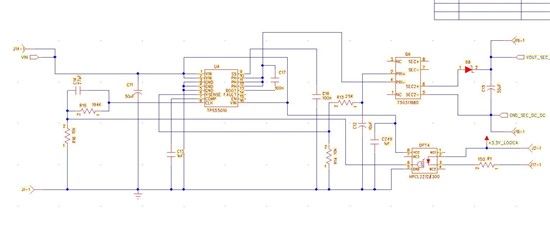

we are testing some samples of TPS55010 and we experienced some problems due to the systematic failure of low side NMOS (?). At the moment we built 7 prototypes and all failed in the same way.
Is there some reason for such instability? We are using the schematic indicated in the datasheet with the magnetic from WURTH 750311880 (also suggested). The PCB looks like the ones indicated in the evaluation board.
The device starts regularly but after a while (e.g. connecting the ground of the DSO to the board) it fails.
Are there some critical issues in the board layout that were not reported in the datasheet?
Any experience?

  • I apologize but I am having difficulty reading your schematic. Please attach a PDF of the circuit. FYI, I have attached the EVM schematic. There are differences which may lead to your issue.
    • Transformer hook up is different.
    • Input capacitance (need ceramic)
    • What is the opto for? EVM doesn't use an opto (I can't really tell which pins this is hooked to due the schematic resolution).

  • Sorry for the low quality. We will provide the pdf. The transformer is connected in fly-back mode in both circuits, our and EVB (in one the ground is up, in the other ground is down but our picture is too lowres to see this, sorry). The transformer is connected with inverted polarity in the two circuits but consistently.
    The TPS55010 was chosen due to its unique feature to synchronize the oscillator from external source, which is extremely useful to reduce common mode on very sensitive isolated acquisition systems (like EEG). We use this feature to synchronize the DC-DC converter with the AD sampling frequency, This information comes from the system, back to the primary side, via optoisolator.
    At the moment we had another failure (the 8th) after 1h of test which ran smoothly. Very difficult to trace.

  • What is your nominal input voltage? TPS55010 is limited to 7V absolute maximum so any transients above 7V can damage the IC. C11 and C12 should be good quality ceramic capacitors. Also if there is excessive input voltage lead inductance, then you should add an aluminum electrolytic to the design.
    Another suggestion is to add a "Y" capacitor across the isolation boundary (C4 on the EVM). The other difference I can see is the secondary hookup for the transformer. While your hookup should work, our 3.3V output uses both secondary windings in series with a lower primary side voltage setpoint (see the datasheet, pg25, table 4). We have not tested a configuration identical to yours. I can try to modify an EVM to your circuit and see if there are issues.
  • We have another question; How is the TPS55010 power pad connected? We don't see the connection in your schematic.

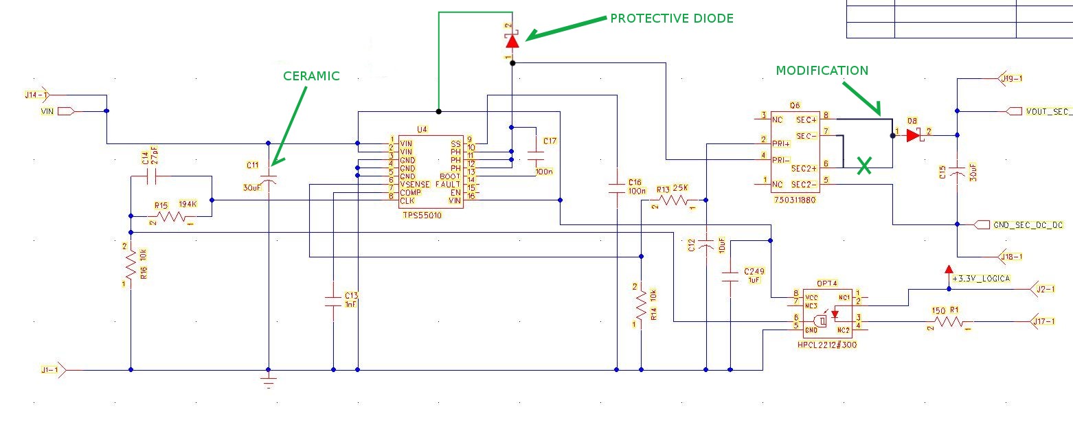

    Input voltage is 5.6V max (very low margin to the absolute maximum rating).
    We argued that transients in the PH pin could damage the low-side NMOS and hence in the last prototype (we will test it tomorrow) we put a protection diode (SS14) in the PH pin to the PSupp (see picture). We will also put the secondary windings in series as suggested. A 1000u low ESR is now attached on the PSupp and a 33uF hiQ ceramic cap is already present.
    Y capacitor cannot be added. This is the reason why we choose the TPS55010. In this way we try to minimize the coupling between Pri-Sec sides. The common mode noise is synchronous with the AD sampling frequency and removed.
    The GND pad below the IC is soldered even if you do not see it in the schematic (it is bounded in the footprint). This was also one of our concerns...

  • Dear Eric,
    at the moment, after the serialization of the secondary side of the transformer and the insertion of a couple of s-diodes on the PH pin (to PS and GND), the cicuit is stable and works nominally.
    We had no other failures.

    To comment on Gianpietro's solution, the diodes can help if the failures are due to excessive voltage on the PH node because this will help clamp it within the limitations. The diode should have a very fast response time. You can also try adding an RC snubber from PH to GND to help reduce it.
