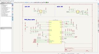

  • Market purchased board is the BeaglePlay (https://www.beagleboard.org/boards/beagleplay) and Newly designed board is the same board I designed with the schematic available (https://git.beagleboard.org/beagleplay/beagleplay).
    Attaching the PDF format for the PMICPlay-SoC GPIO 3.3V.pdfPlay-DC_DC AND PMIC.pdf
  • Thanks for sharing the schematic! The internal parameters for the buck converters are optimized for 0.47uH inductor. Could you change the inductor on Buck1 from 0.33uH to 0.47uH?

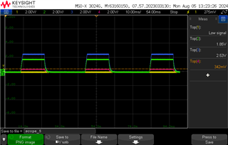

  • I had changed the 0.33uH inductor with the 0.47uH inductor and below is the outputs of the PMIC.
    Pink represents VSYS
    Blue Represents Buck3(Pin 27)
    Green represents BUCK2(Pin 29)
    Yellow represents LDO3(Pin 21)

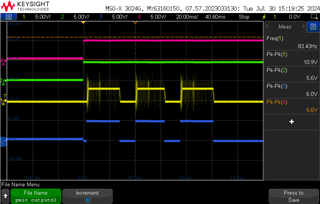

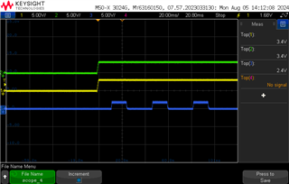

  • Additionally will be sending you one more waveform
    Green represents Enable
    Yellow represents TLV62595 Buck convertor (pin 5 output)
    Blue Represents GPO2
    The last scope capture shows significant noise coming from the external TLV62595 Buck. Could you disconnect the load from all PMIC rails and isolate the power solution?

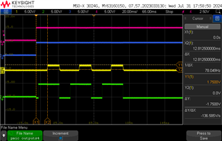

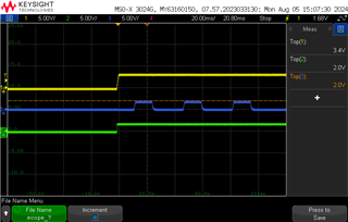

  • Additionally I had also testing the sequence again,
    Blue represents Enable
    Yellow represents GPO2
    Green Represents buck 2 output after inductor.
  • If the green channel is Buck2, does that mean you are getting 5V on Buck2 when it tries to turn ON?
    Brenda
  • sorry, GPO2 is green and buck 2 output is yellow. Please let me know the root cause

    I am also getting a voltage of 1.8V at VDD1P8.
    Additionally. I feel like there could be some error in the Schematic. Please review the schematic and please let me know the minimum circuitry to run the Buck2 output (1.8V) and then remaining buck and LDO outputs

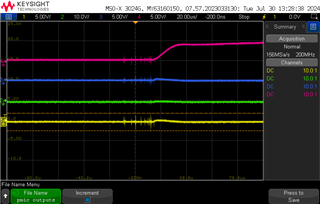

  • Below are the waveforms listed as follows -
    Green - PVINLDO1
    Blue - PVINLDO2
    Yellow - PVINLDO34
    Green - VLDO1
    Blue - VLDO2
    Yellow - VLDO4
    Green - VDD1P8
    Blue - VLDO3
    Yellow - 3.3V out from TLV62595
    Green - PVIN_B2
    Blue - PVIN_B3
    Yellow -PVIN_B1
    Green - LX_B2 after inductor
    Blue - LX_B3 after inductor
    Yellow - LX_B1 after inductor
    Green - EN
    Blue - Mode/Reset
    Yellow - GPO2
  • Hi Mohit,
    Could you provide a picture of the PMIC IC top marking? I'm staring to think you don't have the correct orderable or the channel labels were not identified correctly because I dont see the correct output voltages, sequence and one of the PMIC rails (GPO2) seem to be excluded from the power-up attempts. Here are a few observations:
    Green - VLDO1
    Blue - VLDO2
    Yellow - VLDO4
    • When LDO1 turns-ON, it only outputs around 1.6V-1.8V but the output voltage of this rail is controlled by the VSEL digital pin. If VSEL is high, LDO1 should output 3.3V.
    • Similarly, LDO2 does not have the correct output voltage. TPS6521903 has LDO2 configured to output 0.85V but your scope capture is showing approximately 2.4V. What do you have on channel 4?
    • LDO1 and LDO2 are turning-ON at the same time in your scope capture but the TPS6521903 was configured to turn-ON LDO2 6ms after LDO1.

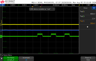

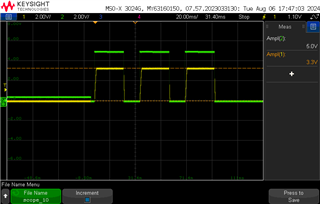

    Green - EN
    Blue - Mode/Reset
    Yellow - GPO2
    • In this capture, I dont see GPO2 going low and high. The PMIC was design to execute a cold reset if an issue is detected in any of the PMIC rails. Your scope captures show some of the PMIC rails like Buck2, LDO1, LDO2 going low and high (3 attempts) but GPO2 seem to always stay ON. PMIC does not do this.

     I will be sharing the photo of the IC that was soldered and also I have made several iterations with no load condition, and the output waveforms remain same. I forgot to tell you the Output of GPO2 is remains high because I was directly pull up the pin by 0ohm resistance instead of 10K as mentioned. Refer to the schematic Resistor R2.
    After now I again put it 10K resistance on R2 and then I am getting the below waveform.
    Green represents GPO2
    yellow represents output of TLV62595.
    After connecting 10K in place of 0R (R2) the output of BUCK U2 is also not turning ON because the GPO2 is directly connected to the enable pin of TLV62595.
