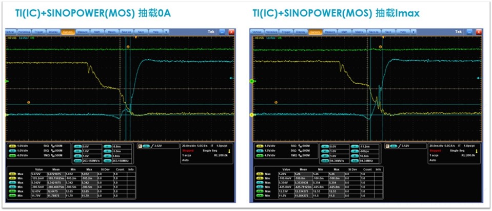

    A switch-node snubber does not affect the UGATE to LGATE dead-time.
    Do you have part number and specification for the SINOPOWER high-side MOSFET?  The PK600AB part number came up with a part from a different manufacturer that looks like it should be turning off in under 20ns.
    It's taking about 35ns for this MOSFET to turn off and the switch node to drop, which is a very long time for the 1.9Ω driver pull-down to discharge the high-side MOSFET with PR4508 = 0Ω, and that long discharge time is what is driving the need for more dead-time on the UGATE falling to LGATE rising dead-time.
    It should also be noted, when driving 2 MOSFET from the same gate-drive, it is generally recommended that each MOSFET have a separate gate drive resistor so that MOSFETs with different gate threshold voltages can switch at the same time and the MOSFET with the higher threshold voltage will not wait until after the other MOSFET has switched before switching.

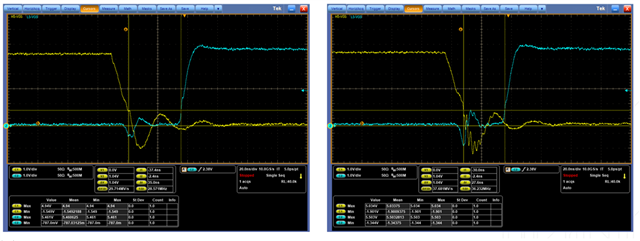

    this is p2p RT6575's deadtime, which looks wider than us with same MOS
    Yes, the Richtech RT6575 has longer dead-times than the TPS51285B.  This longer dead-time results in increased body diode conduction with each switching cycle, higher MOSFET power dissipation and reduced efficiency.
    What is very strange in the comparison is the significant difference in the fall-time of the gate drive between the TPS51285B and the RT6575, given that they have the same driver strength, they should be producing the same fall-time unless the gate drive resistance is different.
    The waveforms from the Richtech device are showing a 12ns fall time.  What we expect from a 7.5nC MOSFET discharged from 5V through with a 1.9Ω resistance and MOSFET gate resistance of 1-2Ω.  We would not expect the MOSFET fall time to be 37ns with a 14ns plateau unless there is an issue with the series resistor, solder joints or damage to the device.
    I would recommend reflowing the UGATE pins, MOSFET gate pins and replacing PR4505 and PR4508 with 0Ω resistors to make sure the issue is not in those paths.  If the TPS51285B is still showing a UGATE falling time of 37ns, replace the TPS51285B as it may be damaged.

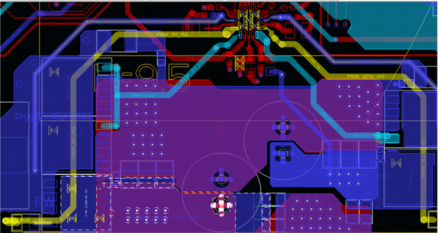

    they tried lots of TPS51285  ICs on other boards but see the similar waveform, so this is not single case. please check the layout below.
    https://e2e.ti.com/cfs-file/__key/communityserver-discussions-components-files/196/242002_2D00_SC.0627WPH2213.7z

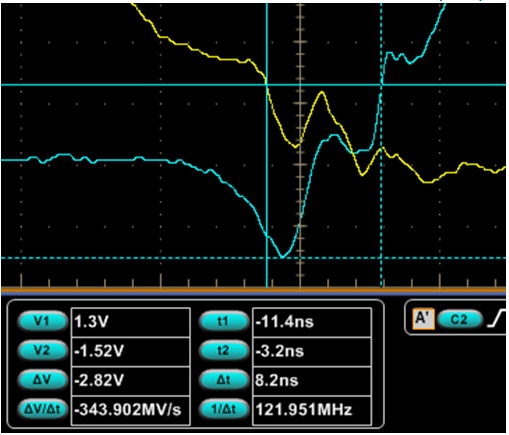

    they manage to insert  1 ohm resistor at LGATE but still fail Lenovo spec (8.2ns < 10ns)
     also they've change HSMOS Qg to 11.5nC from 13.5nC is also fail (7.4ns < 10ns)

  • they manage to insert  1 ohm resistor at LGATE but still fail Lenovo spec (8.2ns < 10ns)
    Why does Lenovo have a minimum 10ns dead-time spec?  That is an arbitrary and fairly large minimum dead-time spec which is negatively affecting their efficiency.

    The layout looks ok, though there are some places it could be improved:
    As I noted before, when operating two MOSFETs in parallel, it is generally best to have a separate series resistor in each gate drive to allow the MOSFETs to have different threshold voltages during switch transition.  This helps balance switching losses and thermals between the MOSFETs.
    Routing the SW connection, which is the return for the high-side gate-drive directly under the gate drive trace for as much of the gate drive path as possible will minimize loop area and inductance, providing the best turn-on and turn-off possible.

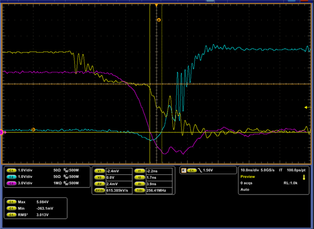

    they found the deadtime  between  SW is close to 0V  and the rising of LSGATE is smaller than the deadtime in our datasheet,
    but is it the right way to prove this?
    The 12ns from the datasheet is measured without capacitive loading on the gate drivers so there is no slope to contend with.
    It's also not measured from SW to GND, the high-side gate is measured from UGATE to LL (The gate-source voltage of the high-side FET)
    If you measure the period of time the switching node is negative under positive load, that is a pretty good measure of the actual anti-cross conduction time.  For internal MOSFET products, we often tune the gate drive for this node to be less than 0.3V for 5-8ns to ensure there is no cross-conduction while maximizing efficiency.
