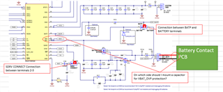

① You said that the capacitor on the BAT terminal can be increased to 200μF to prevent VBAT_OVP after removing the battery, but would it be better to mount these capacitors on the BAT terminal side of the BQ25798, or on the battery connector side?
The BQ25798 and the battery connector terminal will be mounted on separate boards and connected with a harness.
② Also, is it acceptable to use the following ECAS for these capacitors?
https://www.murata.com/en-us/products/productdetail?partno=ECASD41C686M040KA0
③ If the VBUS pin output is enabled and the 2S battery is disconnected and inserted, is it recommended to mount a 0.047μF capacitor on the CSNUB?
    Let me check if there is any problem with unmounted 2S batteries.

  • Hi Kagawa,
    Regarding 1, I recommend placing the capacitors closest to BATP connection, which is the battery pack side of the shipFET.
    Regarding 2, yes because those electrolytic capacitors have very low ESR like a ceramic capacitor.
    Regarding 3, the 0.047uF is not needed for 2S application, especially if you are adding 200uF of low ESR capacitance.
    Jeff

    Using BQ25798EVM, we found that placing the ECAS capacitors as close as possible to the drain side of the Ship FETs will help to prevent VBAT_OVP when the battery is removed. (ECAS 68μF/16V 2 pcs in parallel)
    Therefore, we have incorporated this countermeasure into the actual circuit diagram, and we would like to confirm that our understanding is correct, so we would appreciate a review.
    If you have any concerns about the configuration around the charger, we would appreciate your feedback.
    In particular, we would like you to confirm the location of the ECAS capacitor you mentioned, the BATP terminal, and the BAT terminal configuration.

  • Hi Kagawa,
    The capacitor placement is correct.
    Jeff
