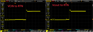

    Besides, could you measure the below voltages?
    Diang
  • Hi Diang,
    Thank you for your response.
    I have checked the voltages at VCIN and VCOUT, and they are only reaching up to 512 millivolts at their highest. Also, connecting MPS_DUTY directly to RTN/VSS didn't make any difference.
    When I daisy chained my PCB with off the self working (PoE)device, both VCIN and VCOUT in my PCB shows about 12.5 volts.
    Also, I thought the issue might be with the TPS2373-4RGWR chip, so I replaced it with  IC from the working PoE module, but the problem remains same.
    Now, I'm starting to get little nervous. Confused
    I've also measured the DEN voltage, which peaks at 0.57 volts and averages at 0.354 volts. Is this normal?
    For your reference, PSE detection signature voltage is around 2.54V average with peak 4.36V but when I connect my PoE PCB voltage drop to peak 2.84v and average of 0.94V.
    Also, I supplied 5V DC to 1P12 and 1P36, current leakage/consumption was around 150-250uA.

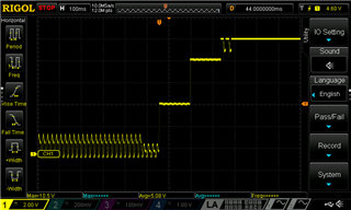

  • Hi Shrawan,
    Sorry that my last message is not very clear. For the voltage measurement, besides VC_IN, VC_OUT, could you also get the RTN-VSS voltage as the green line in that waveforms?
    When you have 5V DC to 1P12 and 1P36, the current should be around (5V-1V) / 25k = ~160uA, where 1 V is voltage drop at the diode rectifiers (U1 and U2), while ~140 - 230 uA could be possible depending on the components selection. RTN-VSS waveform will help to observe if detection is passed.
    Besides, have you tried to short PS_DUTY with VSS? And can you show me the termination circuit? Sometimes there are too much capacitance added for the termination circuits and caused the overall Cdet between VDD-VSS higher than 0.12 uF.
    Diang
  • Hi Diang,
    I really appreciate your time in helping me.
    Below image is voltage waveform of RTN-VSS and DEN-VSS.
    Yes I tried shorting MPS_DUTY to VSS did not change the behavior. Below image is the termination circuit i have used to test this PCB.
    Also, One thing i noticed when I was daisy changing with working PoE is if i connect all 4 pairs both PoE module doesn't work. If I connect only 1P12 and 1P36 during daisy chain all works fine.
